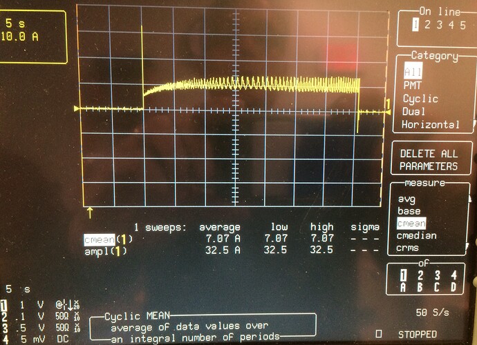

We tested three compressors, using an oscilloscope and current probe to measure (1) initial peak surge current, (2) average current draw during charging, and (3) time to full charge. The test system capacity was 48 cubic inch (3x Clippard AVT 32-16). In each case the duration of the initial surge current was ~0.05 second, rising to its peak in about 0.005 second and decaying exponentially to steady value after that. I have attached a typical oscilloscope plot of the compressor current, 50 seconds full horizontal scale and +/- 40 Ampere full vertical scale. This plot is for the Thomas compressor; other plots are similar in form but differ in their initial peak surge, average current draw, and time to full charge as summarized below.
Viair 90C: initial peak surge 18 Ampere, average current draw during charging 12 Ampere, time to full charge 40 seconds.
Thomas 405ADC38/12: initial peak surge 32 Ampere, average current draw during charging 10 Ampere, time to full charge 36 seconds.
Viair 250C-IG: initial peak surge 40 Ampere, average current draw during charging 9 Ampere, time to full charge 33 seconds.
Interesting that the efficiency correlates so well with initial peak surge. Assuming the voltage was constant at 12.5V throughout, the 90C needed 6.0 kJ, the Thomas 4.5 kJ, and the 250C-IG only needed 3.7 kJ from the battery to do the same job.

My test results above were made using the highly illegal method of series connecting a pressure switch to the compressor – the opposite of soft-starting!

Yes, we started with the tanks empty. I was looking mostly at peak surge current with the 'scope. A stopwatch would suffice to measure refill time, and that should be much shorter than the 0-120 fill times reported above.
Also, I would expect bigger differences in the compressor comparisons for 100-120 refill times, based on their published flow curves.
BTW, the peak surge transient (50 msec) we observed would not trip a breaker or blow a fuse.
