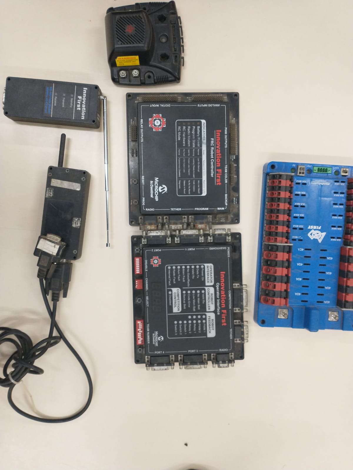

My mentor brought old equipment from the time of 2006, and suggested that we do a separate project using the equipment. The problem is that we haven’t found any guide or tutorial for programming and wiring yet. Do you have any ideas?
@Mark_McLeod
And I’ll go with… I wish you the best of success. Jaguar is a bit newer, as is the PDB, but they’ll work.
Ah, the good ol’ PIC days!
Kevin Watson had many software resources for teams back then, his site is surprisingly still available: https://kevin.org/frc/
It appears 358 has an incredibly thorough archive of the '04-'08 control system: Team358.org - Robotic Eagles - FIRST® Robotics Competition
