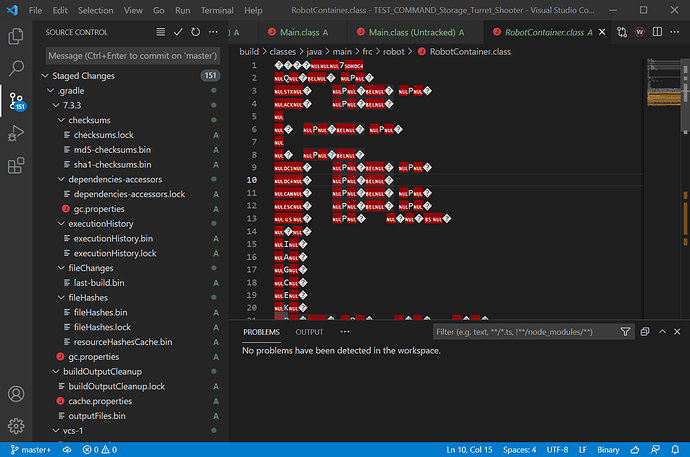

I believe I accidentally clicked “Discard All Changes” in Source Control in VS Code while I was trying to figure out how to upload my code into GitHub. Now my code looks like this below.
Additionally, the folders that contained all my commands and subsystems are empty in my WPILIB project folder as if as if nothing was there in there in the first place. I also, looked in my recycle bin to find out if anything was in there as well. Nothing.
I had done some research already and I learned that I also screwed up by having not done any commits. So I am already trying my best to remake the code however I am wondering if there is anything I could salvage in order to lessen the work I will have to do? Thank you so much and good luck to you all!
If you still have the .class files then there’s hope, but not a guarantee.
First, create a new WPIlib project in a different folder.
Now, you’ll need to put each .class file (or the .jar if you have it) into a Java decompiler. I gave this one a quick check and it looks like it’ll do what you want, but you’ll lose comments.
Save each resulting files in the src folder of the new project. Make sure that they’re all in a folder structure similar to the original. (If you did the jar file, only include the files that you actually wrote and not all the wpilib files)
At this point, immediately make sure it builds, and then commit. In addition, you should push it to a remote repository (github, for instance) to avoid losing work again.
Now you can continue adding comments back in and implementing new features. I highly recommend committing often and pushing regularly. Git doesn’t track all changes, it only tracks the specific changes that you commit and push.

THANK YOU SO MUCH! It works!
AHHHHHHH.
This is how I followed your solution:
  1. Found the .class files in
    “WPILib Project Folder” > build > classes > java > main > frc > robot
  2. Upload file(s) to a Java decomplier like this one and if all goes well
  3. You have your files back without any comments
