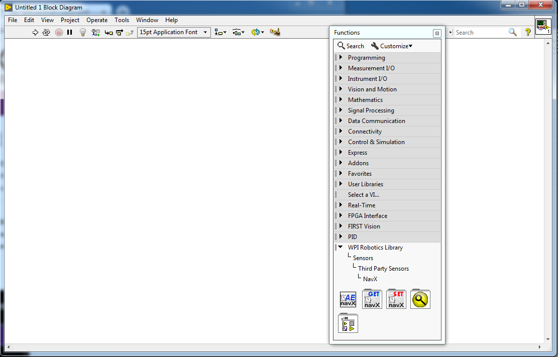

Here is the process I followed to see the library:
  1. I just installed the navX libraries from: LabVIEW navX-AE.
  2. Unzipped the installer and ran it
  3. I saw the files were in: C:\Program Files (x86)\National Instruments\LabVIEW 2018\vi.lib\Rock Robotics\WPI\ThirdParty\Sensors\navX
  4. I looked in the Sensors palette in LabVIEW and it was under Third-Party there:
Does this work for you?
#7
After running the installer, the files did show up in the file location above, but dont appear in LabView. Are work around for this was just copying and pasting the Navx folder into the user library section. Dont know what caused the issue.
#8
You may need to restart LabVIEW.
You can also manually edit the pallet by going to Tools -> Advanced -> Edit Pallet Set…
Keep in mind if you have multiple LabVIEW computers and you copy the files, you will need to repeat that process on all the LabVIEW computers.
