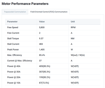

If we compare the brushless motors we plan to use, Kraken X60, Falcon 500, NEO, and NEO Vortex on paper
Kraken X60
Falcon 500
NEO V1.1
NEO Vortex
Free Speed Rank

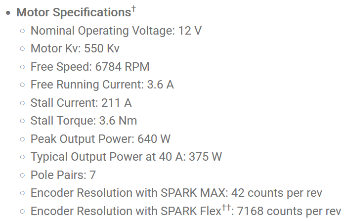

  1. NEO Vortex: 6784 RPM

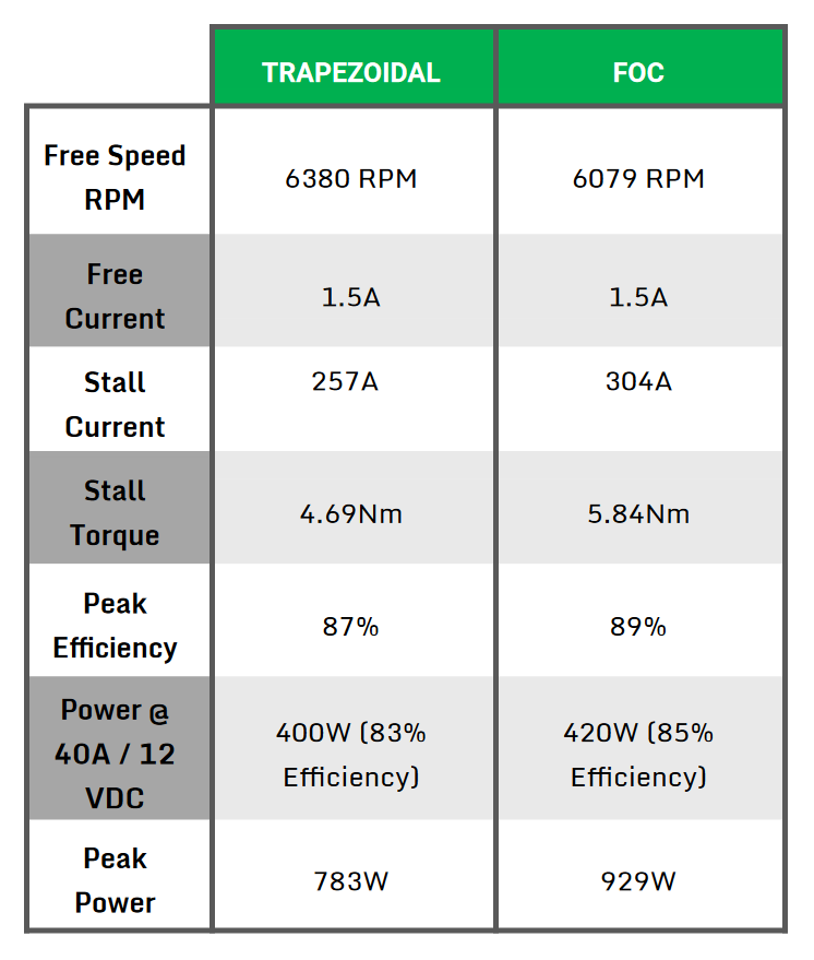

  2. Falcon 500: 6380 RPM
  3. Falcon 500 FOC: 6079 RPM

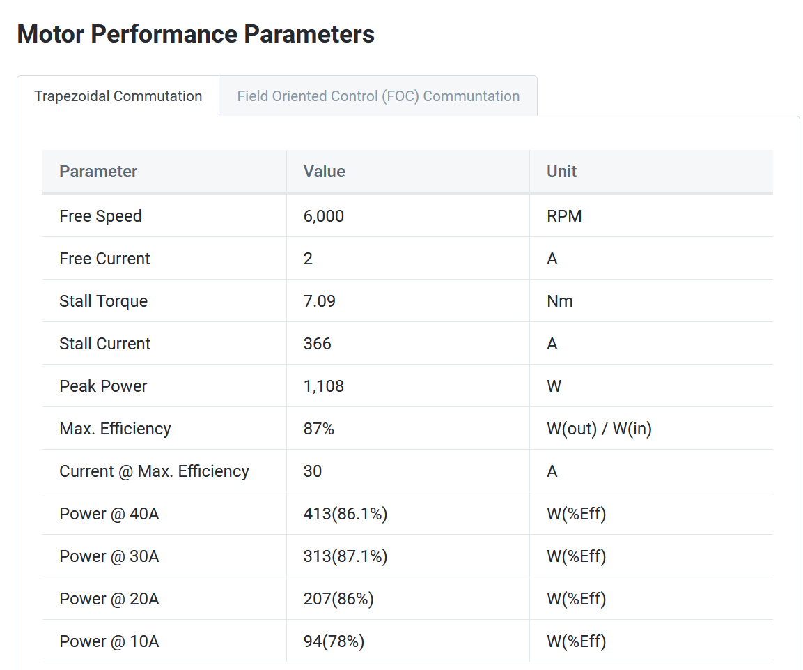

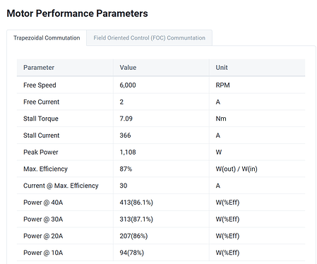

  4. Kraken X60: 6000 RPM

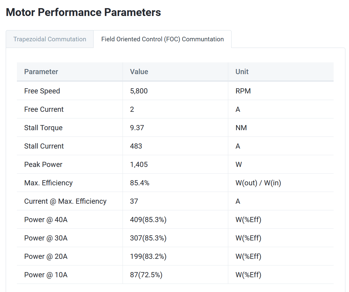

  5. Kraken X60 FOC: 5800 RPM
  6. NEO: 5676 RPM
Stall Torque Rank
  1. Kraken X60 FOC: 9.37 Nm
  2. Kraken X60: 7.09 Nm
  3. Falcon 500 FOC: 5.84 Nm
  4. Falcon 500: 4.69 Nm

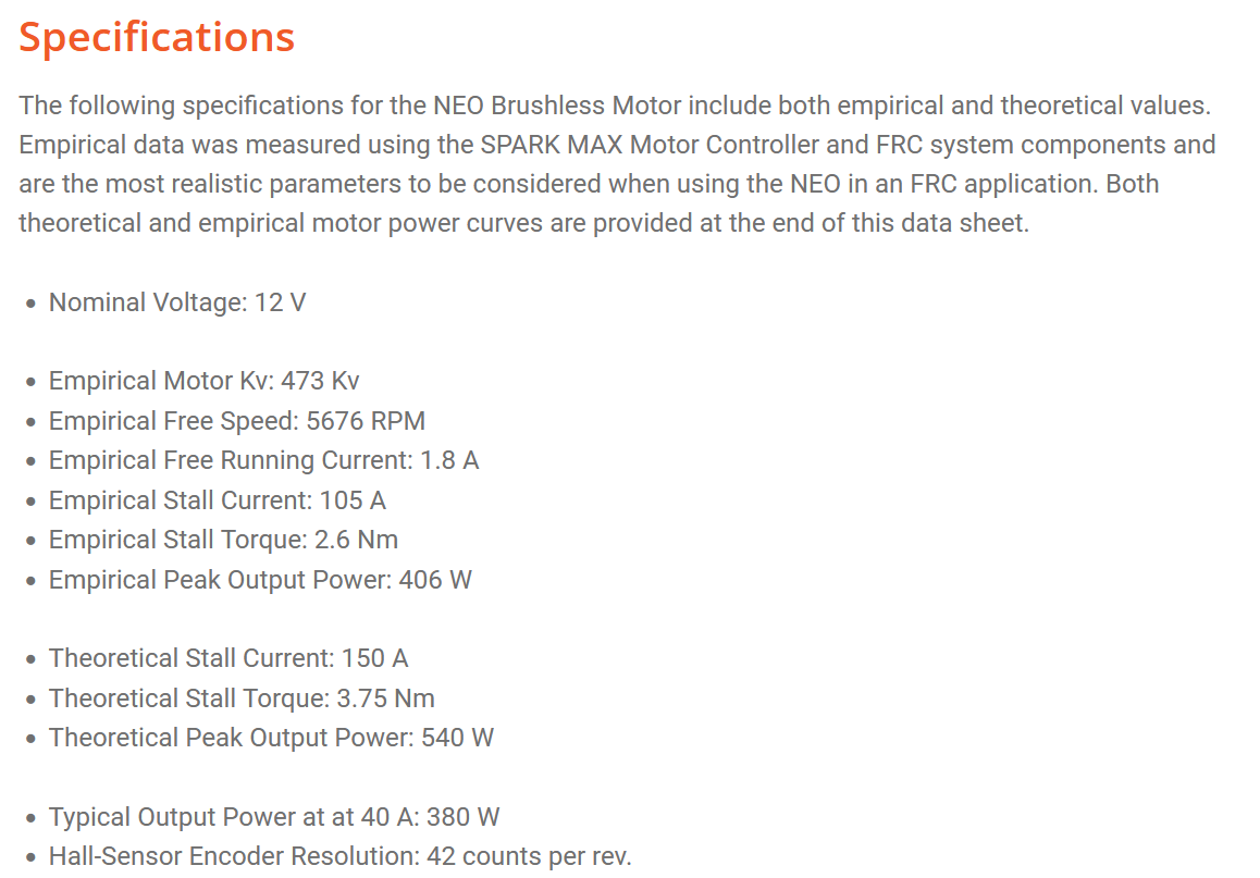

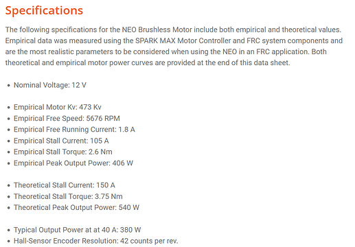

  5. NEO V1.1: Theoretical at 3.75 Nm
  6. NEO Vortex: 3.6 Nm
  7. NEO V1.1: Empirical at 2.6 Nm
The Vortex has the highest Free Speed at 6784 RPM and the Kraken X60 has the highest Stall Torque at 9.37 Nm with FOC. If you don’t want to pay for FOC, the Kraken X60 still has the highest Stall Torque with 7.09 Nm.

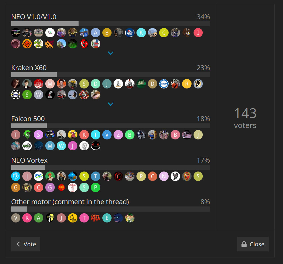

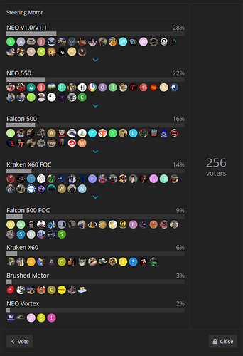

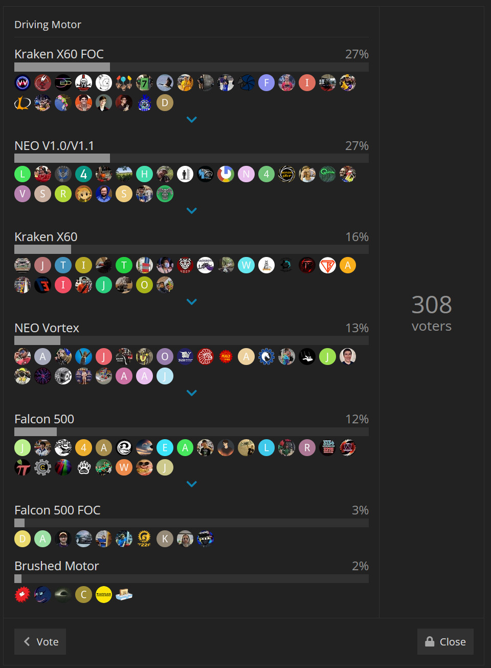

But that is all on paper. So I did a 2 poll. One asked what motors are you planning on using for swerve, and the other asking what motors are you using for your shooter.
The results seemed interesting.
For Swerve, Kraken X60 FOC had the majority for driving and NEO V1.0/V1.1 had the majority for steering.
Swerve Results as of 2:34 AM CST
For Shooter, NEO V1.0/V1.1 had the majority.
Shooter Results as of 2:34 AM CST

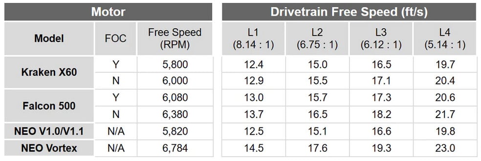

For the Shooter, I expected the NEO Vortex to win cause of its high Free Speed, same for Swerve but most people choose the Kraken X60 FOC which is fifth against the other motors on RPM but number 1 on Torque. Is Torque more important for Swerve than Free Speed? Even SDS’s page has the NEO Vortex being the fastest option
Of course, the poll could be skewed due to the current stock issue with some products and/or for what teams had in hand.

I think a lot of those poll responses would have come down to what motors teams have on hand at the moment and what motors they are expecting to receive from back orders.
I know we would love to be in a situation where we have a choice. In Australia we committed Falcons order numbers in Mid 2023 with a local supplier, only to be told in December that they weren’t going to come at all for the 2024 season.
This was after everyone had completely back ordered all the new motors out of existence.
I think every one should have to use sim motors and mag encoders to level up the playing field across the world.
Free speed can be exchanged for stall torque by changing the gear ratio of the mechanism the motor is attached to. Increasing the ratio multiplies the stall torque and divides the free speed by the same factor. What you should really care about is the motor’s max power, or (free speed)*(stall torque)/4. That will actually tell you how strong the motor is.
You might be interested in playing around with AMBCalc’s motor curve generator and reading the relevant docs.
