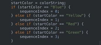

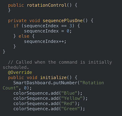

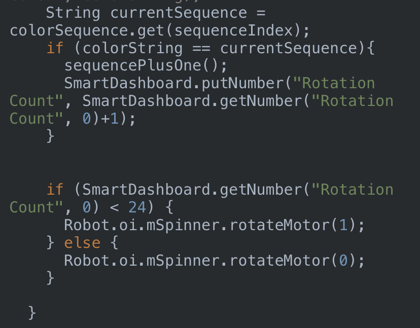

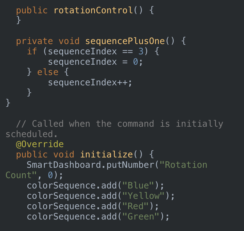

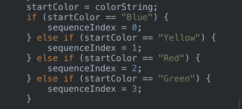

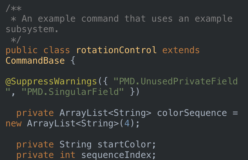

What I did is before spinning, retrieve what color the color sensor is reading. I start the sequence from that particular color in the array.
It will only addcount if the next color sensed matches with the next one in sequence of the array. We did 24 counts (equivalent to a 3 rotations) because our motor controller is set on coast.
