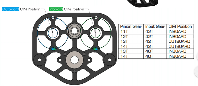

Does this gearbox have the snowman mounting holes? Make sure the motors are in the correct position based off the pinion. There is a chance maybe one of the motors shifted and results in higher load when running one direction.

To double check we have our cims mounted in the correct snowman holes, according to the vexpro instructions, we should have one motor mounted inboard and one mounted outboard. Is that correct?
Both should be mounted the same way. It depends what pinion/ gear combo you have, as to whether it’s inboard or outboard.

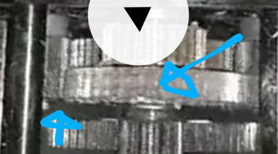

It appears that your retention ring for one of the pinions is grinding against the gear it’s driving.

After unscrewing and looking at it, it appears that the bolt can slip between the snowman hole. Do you any suggestions for fixing this or should we swap this plate for one that on a spare gearbox?
If you have an extra swap it at this point. Many teams have made the mistake of not swapping and paid the price.
With proper torque and initial alignment, it’s usually never an issue. For safety’s sake, make sure the motor is shifted as far out as it can go when you screw it down, to prevent too much mesh.
On a seperate note, as grainy and low rez as this screenshot is, it looks like the middle gear is kinda messed up on the edge by the retaining clip.
Screenshot_20200228-171903~2

We have 11T pinions and a 42T spur gear in our WCD. So this means that we should have both cims mounted in the inboard position. Last year we used 12T pinions with the exact same gearboxes and mounted the cims with 1 inboard and 1 outboard. We actually have this setup on our practice chassis and it spins without any significant resistance.
Also yeah, we previously put shaft clips in those pinions incorrectly and they wore down the spur gear where you pointed. Earlier today I replaced the clips and put them on correctly so now they don’t contact the spur gear.
