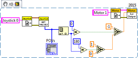

How do you program the POV on the Logitech joystick to move one motor using lab view?
On your joystick block, there should be an output for “POVs” which returns an array of integers. Index the first element of that array, and it’ll give you the angle that the POV is being pressed. If nothing is being pressed, the value is -1.
Up is 0
Right is 90
Down is 180
Left is either -90 or 270; I don’t remember

How do you program the POV to move a motor up and down? sorry we don’t have much experience with lab view.
I don’t have a joystick with a HAT in the shop I’m in right now, so I won’t be able to test this until tomorrow at the earliest, but this is the idea.
What is the box at the bottom of the diagram labeled POV and how do you add it?
That’s not actually necessary.
It is called an indicator and just gives us a display on the front panel of the live values of POV when you run the code in Debug.
You get it by right-clicking on the wire or output node on the vi and choosing Create->Indicator
How do you connect the POV to PWM 4?
The snippet Mark posted shows how to control any motor you like. He called it “Motor 1” in his example. You can call it whatever you want in the string wired to the Refnum Get. Just Open it as PWM4 in Begin, and wire the device reference to a Refnum Set with the same name.
