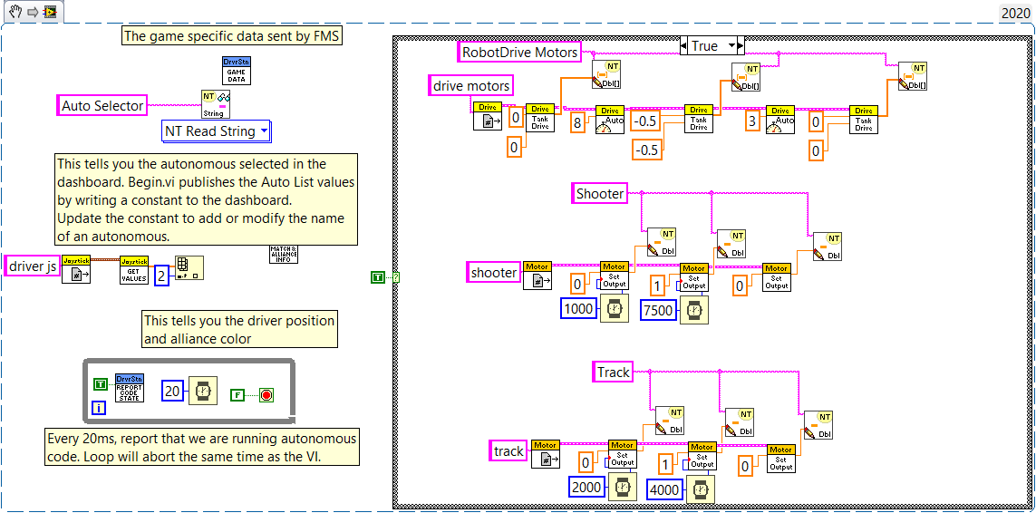

Hello! I have been tasked with programming our team’s robot for Rapid React, and I am completely new to LabVIEW. Unfortunately, no one on our team has previous experience with FRC because everyone who did has already graduated. Instead of copying the previous year’s code (which placed all robot drive code in Teleoperated.vi), I decided to try follow some advice I saw online and code almost the entire thing in Periodic Tasks.vi. I definitely bit off more than I can chew, but the drive controls work perfectly and they do everything I wanted them to do. For whatever reason, I can’t seem to figure out Autonomous. I attempted to copy the code from last year, but it did not work (I suspect it is because I used Periodic Tasks.vi). I then tried to experiment using Flat Sequences, but only the drive motors work. The ball shooter turns on for a split second, which is obviously not what I want it to do. Here is the code I made using a Flat Sequence Structure:

It looks like whatever values you set in Autonomous will immediately get overwritten by your value sets in Periodic Tasks. In that top loop.
The problem is you need to set values taken from the joysticks only in Teleop.vi, because that’s when the joysticks are active.
During Autonomous the joystick values are not passed through from the Driver Station and are always zero, and you want the values set during Autonomous to be the only place values are being set.
Summary:
  • Set the actuator (motors/pneumatics/servos) values you want to be active during Teleop in Teleop.vi (pretty much the contents of the top loop-not the loop itself though.)
  • Set the actuator values you want active during Autonomous in Autonomous Independent.vi
  • Have Periodic Tasks.vi operate only on the values already in your global variables, like you do in your second and third loops. Don’t set or change actuator values in there.

Your Auto as you had it in your first post in the flat sequence should work.
You do NOT want to directly set any motor outputs in Autonomous, because they are already being set in Periodic Tasks.vi.
The same problem will occur with Autonomous setting the motor output and immediately being clobbered by Periodic Tasks resetting the same motor.
Only set any motor one place in your code to avoid conflicts like that.
Directly setting motors in Autonomous Independent.vi will only work if you also only set the motors in Teleop.vi, because Autonomous Independent.vi and Teleop.vi never run at the same time to clobber each other.
Once you moved the motor sets into Periodic Tasks (runs all the time in all modes) you can’t set motors anywhere else.
