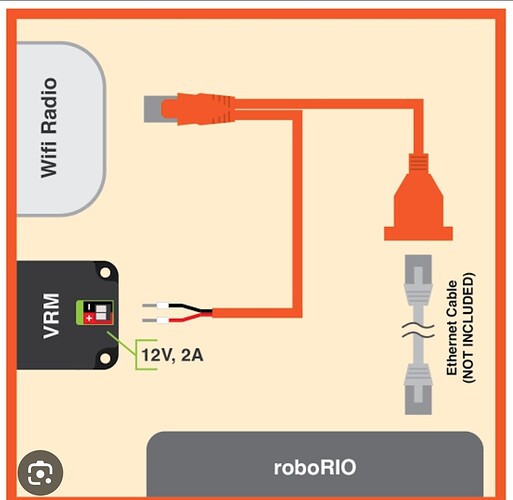

Right. I’ve eliminated the radio as a source of problems mainly because of this message that always appears in log events exactly when we lose comm.
"Warning 44002 Ping Results: link-bad, DS radio(.4)-GOOD, robot radio(.1)-GOOD, roboRIO(.2)-bad, FMS-GOOD FRC: Driver Station ping status has changed. Driver Station "
I didn’t notice any messages regarding the radio in the moments we lost comm during matches, is always this “roboRiO - bad”.
About the wiring, we just connect the radio to the RIO via POE cable (and ethernet cable on the other end) - exactly like this image.
