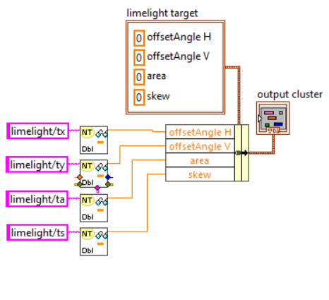

This is my first time trying to program something in LabView using Limelight and i’m confused on where to start. I copied the code from the website but i’m not seeing the code reading any limelight values when i give it an output to the panel.

  3. Post your code and help us understand what you’re trying to read and where you are reading it? If the above 2 tests are ok, then you must be doing something wrong in your code and the only way for us to help is to see your code.

3:
Screenshot 2024-02-22 110621
Forgot to add: This was in periodic tasks, i’m not entirely sure where to put the limelight code.

So i did that and it’s still not working. I think it’s a coding issue, the NT indicator on the driver station says it’s reading the Network Table. Am i using the right name to call it? I also changed the code in autonomous to this to check if it’s reading the data.
Screenshot 2024-02-26 152155
just a couple points about that snippet;
  1. the OPEN should only be in the BEGIN.VI and after it should at least folow a SETREF command and a name for that motor
  2. if that code is meant to turn a motor by the /ta value * 8, then there needs to be a GETREF using the name you gave it in the BEGIN and that command feeds the SET command
