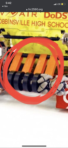

Help. What are these belts called
Polybelt, polyurethane flat belt, polycord flat belt, etc.
“Flat urethane rubber belting” on various sites such as McMaster
or similar
