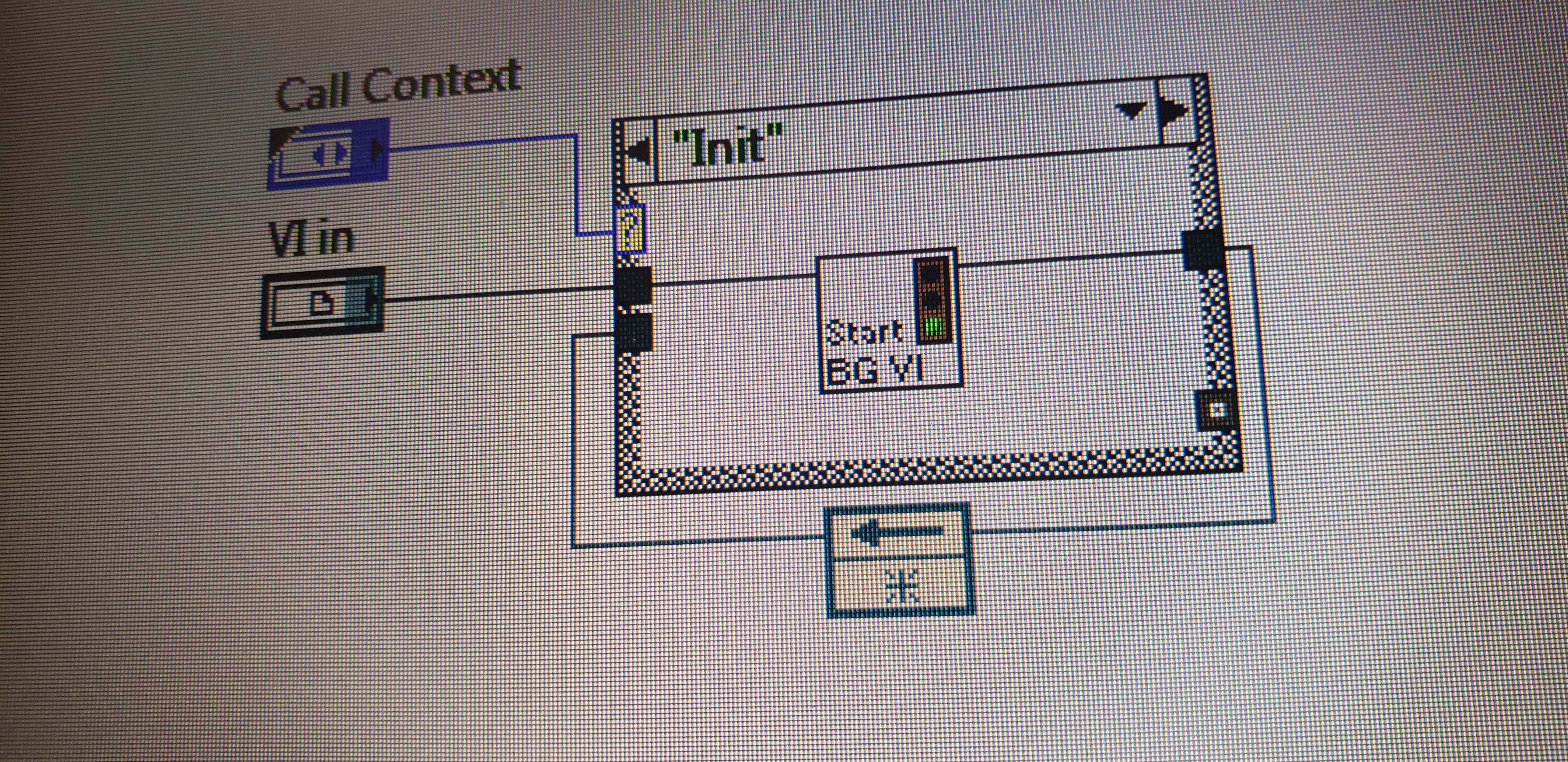

Does anyone know where to find the Start BG vi?
As opposed to just double-clicking on it to see the code inside the vi?
To locate the original library function you can right-click on it and choose “Explore…”
The library function itself is in LabVIEW 2019->vi.lib->Rock Robotics->WPI->DriverStation->WPI_DriverStationStart VI Asynchronous.vi
Be careful not to modify it accidentally.

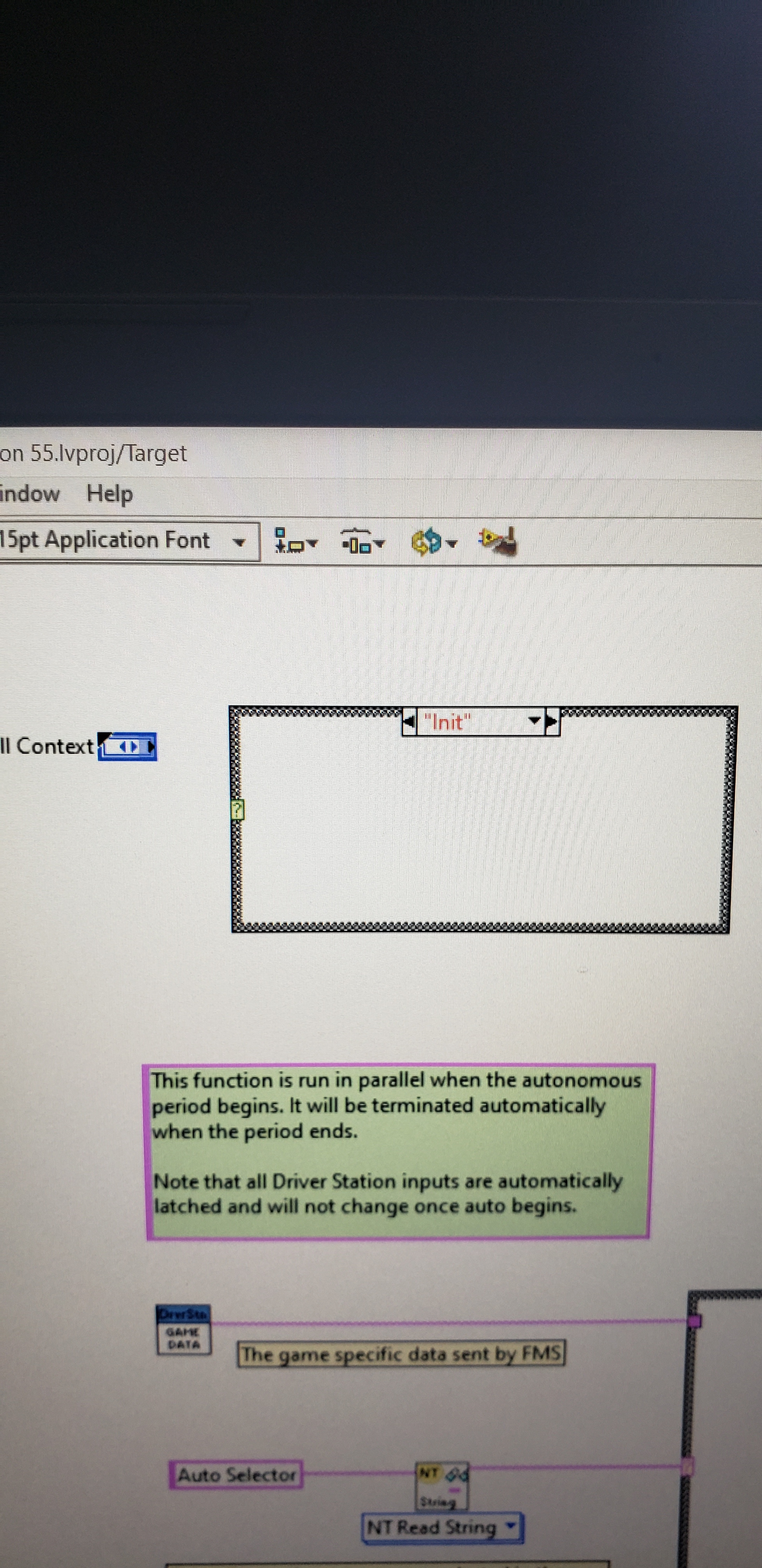

This is what I have on my program this year the other picture was from my code last year. Everything I download or transfer from last year that is what the code looks like.

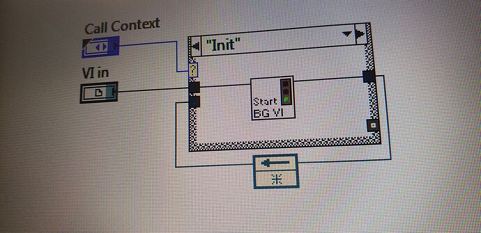

That is off of the robot template it got deleted and then was saved over it
Everytime I try to open a new template it’s still missing
You might want to reinstall the FRC Game Tools in said computer.
Do you see the VI in the location that Mark pointed out?
C:\Program Files (x86)\National Instruments\LabVIEW 2019\vi.lib\Rock Robotics\WPI\DriverStation\WPI_DriverStationStart VI Asynchronous.vi
