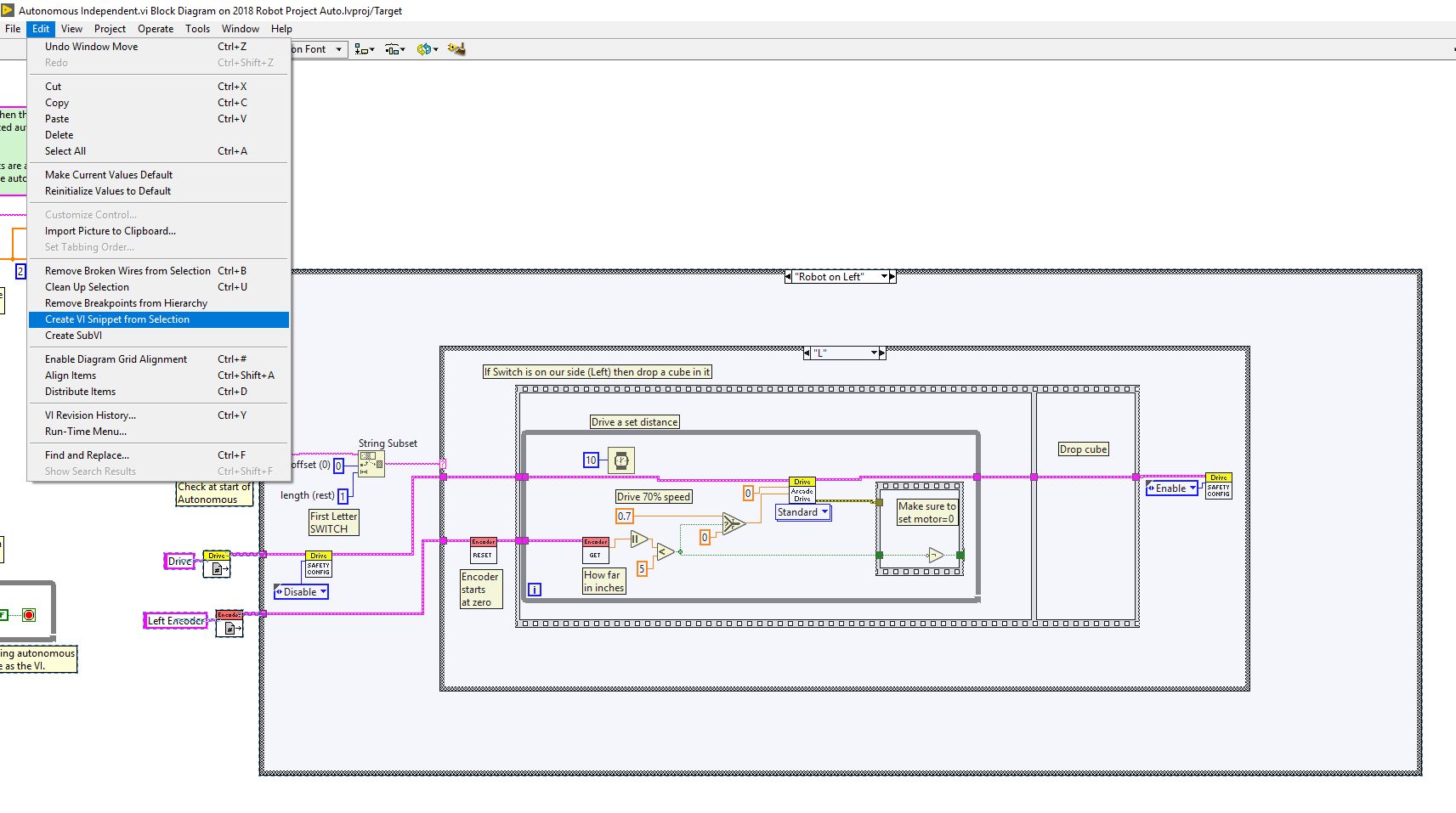

I have been working on getting a third arm working in autonomous. I am using labview and cant figure out how to get a third arm to move independently form the drive motors. i have the motor named, but because it is not a drive motor using more than one PWM i cant get it working in autonomous. can anyone help? thank you in advance.:confused:
  1. How is the motor Opened?
  2. How is the motor controlled?
  3. Can you post code? We can help you debug the mistake.

I have set up my program almost exactly like yours (the names are personalized) but it still wont move my arm.

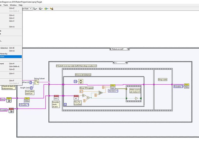

file:///E:/Screenshot%20(4).png this is what my autonomous program looks like. could anyone tell me what i may have done wrong, because it still isn’t working.
Sorry, I would show you my auto but i dont know how to post it as a picture off my flashdrive. ::ouch::
You can post it on a third party site like imgur, then use the img] tags
OK. Thank You.
This should be the program. If there is a problem, notify me, please. It’s an issue on my end. :smiley:
The code looks okay.
What is your Auto Selector set to and what do you have in the other cases?
You might be running a different case and not the Default one.
I actually had to implement my code into the default program, because it was not working originally and now i am not capable of getting the arm to work. but the wheels will turn.

So, you removed or commented out ALL code in the other cases?
