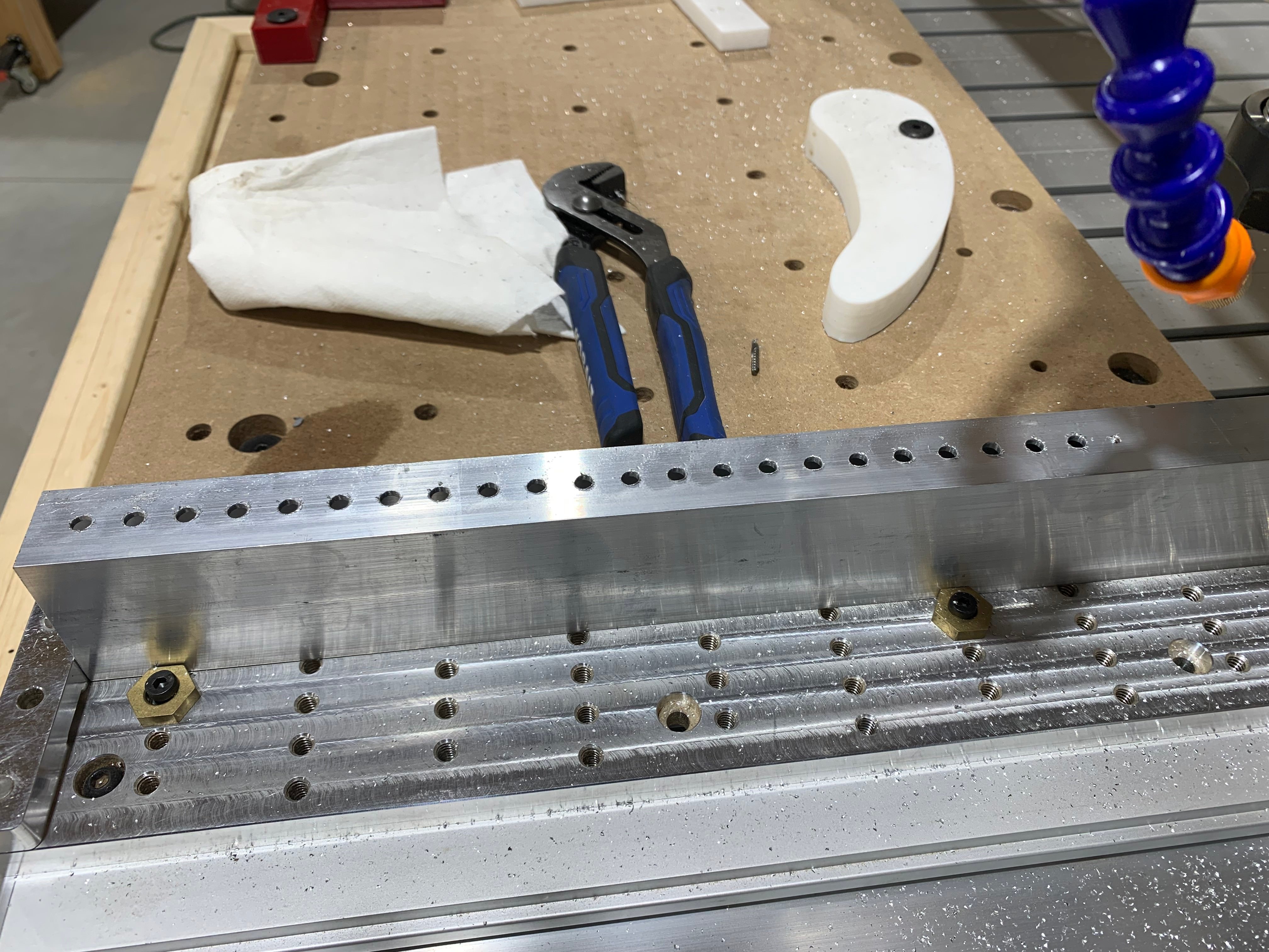

Good morning. Our team is just getting into the CNC game with our OMIO X8. One of the first things we tried to do was drill 50 rivet holes into a piece of 1"x2" tube (After doing practice holes 3 at a time). We got some tool profiles from another team as a place to start with the speed and feed rates. We are using this single fluted 1/8" end mill and trying to mill .201" holes. During the milling process, the end mill broke after around 20 holes. This happened a couple of times.
Any suggestions on what settings we might want to tweak given that it fails after about 20 holes? Is it a heat build up thing or is it just random when it broke? We have air and coolant mist blowing on the end mill during the process. Our current settings are 20,000 rpm, 56 ipm feed rate, and 18 ipm plunge. Pass depth is set to .015 inches so I think the CAM software says it’ll take 5 passes to go .075 inches down. There doesn’t appear to be any chip welding on the end mill after it breaks. The CAM is set to do a profile cut with ramping at 5 degrees. What other settings are important to know?

You’re feeding .0028ipt, which is an extremely high load for an 1/8in tool. Getting closer to .001ipt will prevent excessive tool deflection. I am assuming that you’re using a 1-flute tool. If not, I strongly encourage the use of 1-flute carbide tooling on routers, especially 1/8in diameter.
By using just a .015in DOC you are concentrating all of the tool wear in that first .015in of the tool. Rather than discrete step-downs I would suggest helical bore operations for all of these holes, then a .005-.01in cleanup pass on the diameter at full-thickness DOC.

Not using a drill bit is probably due to lack experience. When we ordered the OMIO we were told we’d want some different sized end mills, no one mentioned the ability to use drill bits in it. I did read an old thread on here this morning that mentioned the idea so it’s something I’m willing to try. When using a drill bit, I assume we should switch to a drill operation as opposed to a profile cut in the CAM software. The McMaster 28765A61 has a size of .191", if we truly want holes .201" would we better off with the McMaster 28765A57, which says is .201"? Which size collet would I put either of these drill bits in? Is it better to use a collet sized a little bigger or smaller than the shaft size? Sorry if these are silly questions, I’m a computer guy trying to take a dip in the mechanical ocean. Thanks again for your advice.

You would want to use a drill bit sized for the hole you want. If you want 0.201" holes, use a 0.201" drill bit and use a drilling toolpath to make only vertical moves. Collets have a clamping range that maxes out at the stated size and goes lower than that. For a 0.201" tool, you would want a 7/32" collet. Here’s a McMaster page for ER-20 collets showing the clamping range. I think the OMIO uses ER-20.

If we’re only doing a couple holes we interpolate with a 4mm endmill but always use a drill if there are more than 20 or so holes.
0.201" is a little big if you’re riveting CNCed parts to CNCed parts with 3/16" rivets, which is why we prefer a #11 drill. A #9 is probably the biggest I would go.
We use a 5mm collet for a 0.193" Drill. A general rule is you never want to use a collet smaller than the tool, but you can safely use a collet about 0.02" larger than the tool. I wouldn’t run an off nominal size collet for an endmill but it’s fine for a drill. Some metric collets will even have a range marked on such as “5-6”

For the example you have given, bump up your spindle to 24k rpm and drop your feed rate down around 15 IPM. Your step down can be larger (.03-.06 in) and I will second the recommendation to use a helical plunge. That’s how I run it.
