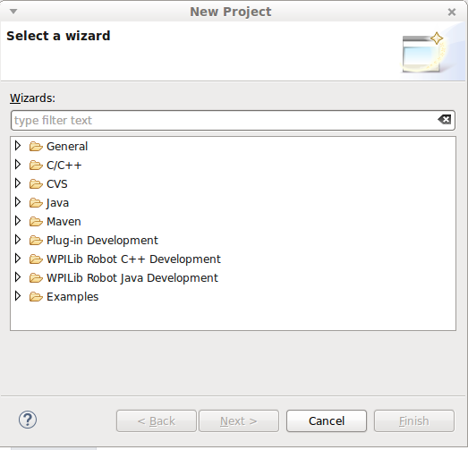

When I click on File/New/Project I see the following in Eclipse Luna:
http://fdcga.com/images/NewProject.png
If you don’t then I agree that for some reason your plugin didn’t install correctly.

Click File > New > Other > (WPILib Robot Java Deveopment) > Robot Java Project
Not just Project. Also, ctrl+n should get you there.
