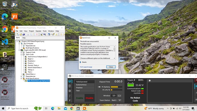

Help with NI Licensing

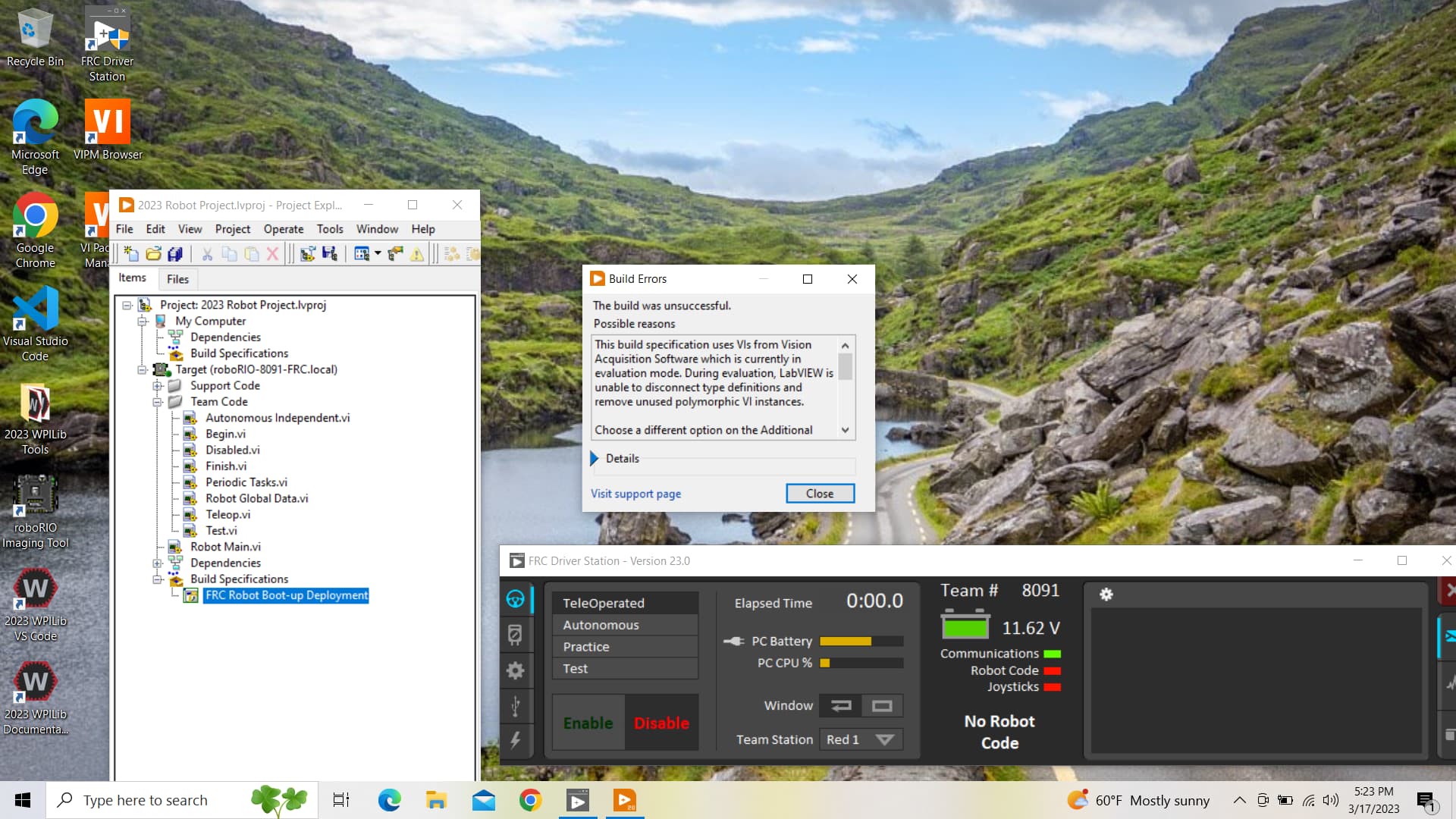

This build specification uses VIs from Vision Acquisition Software which is currently in evaluation mode. During evaluation, LabVIEW is unable to disconnect type definitions and remove unused polymorphic VI instances.
Choose a different option on the Additional Exclusions page and build the application again.
To purchase this product, please contact National Instruments. If you have already purchased this product, select Help >> Activate LabVIEW Components to activate this product.
C:\Program Files (x86)\National Instruments\LabVIEW 2020\vi.lib\vision\driver\IMAQdx.llb\IMAQdx Enumerate Cameras.vi
I know this has probably been asked and answered… However, being a very tired, frustrated, and demoralized teacher I am asking again. Can someone please explain to me in plane English what this means and how I make it go away? Thank you.

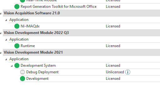

Hi, if I remember correctly, you can use LabView in evaluation mode and everything will work, except for Vision code. Once you apply your LabView license the Vision parts will work. To find your LabView license look in your FIRST Dashboard under Passwords/Voucher Codes.
Once this is done, put them into NI License Manager it should finally look like this:
Hope that helps!
Adding to this, your team’s lead and alternate coach should have access to this for you (assuming you’re not one of those roles)
