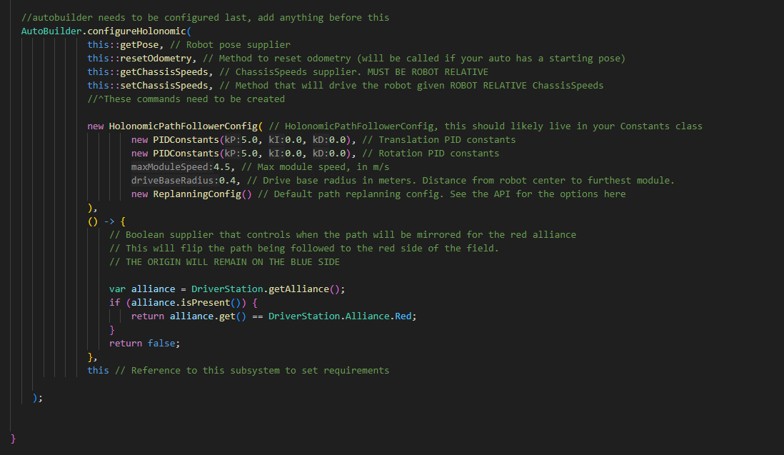

Hello everyone, I am from frc team 108 SigmaC@Ts and my team and I have been struggling with trying to get our robot to drive while rotating in autonomous but when we try to run it, it is just rotating in place jittering from rotating left then rotating right. And we just started using swerve drive last year and came up with the same issue so we had to stick to basic straight line movements. Here is our github: SigmaCode2023-Pathplanner2024_Testing

Pathplanner needs robot relative speeds
Code taken from their site:

Yes. So some of the problems that I came across was unit conversions for the swervekinematics, inverting the robots heading (counterclockwise is suppose to be positive and clockwise is suppose to be negative), setting the max module speeds accordingly, and making sure that the chassis speeds outputs to the configuration of the configurations of holonomic were relative speeds
So should the max speeds in PathPlanner match the max module and robot speeds in your code or does it work when the max speeds are lower in PathPlanner?
I was working with it and it seems like whatever you write in the configuration will change the actual speed but I would say match the speeds in pathplanner with the max module speeds you put in the code unless you need for parts of the path to go of a lower speed
