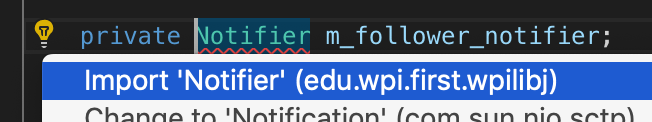

Thank you for the reply, which library should contains the Notifier class? VScode says the object is not defined when I try implementing it.
try adding this import at the top of your file: import edu.wpi.first.wpilibj.Notifier;
Also FYI, VS Code has a cool feature where a light bulb appears in the left margin when you click on a line with an error and you need to import something, misspell something or another quick fix.36%20PM
