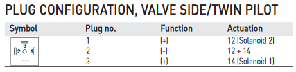

We are trying to get our 2014 robot working again as a demonstration bot. Our main problem right now is that we don’t know how to wire the solenoid that controls our shooter. It is a Norgren V60-series with a EN 175301-803 Form B (3 pin) connector. It appears to require three wires, so I have no idea how to connect it to the PCM. Connecting the positive and negative terminals to the PCM doesn’t work.
It depends on the specific model, but in general the wiring directions are in the spec sheet.
2 is ground, 1 and/or 3 is each solenoid.
