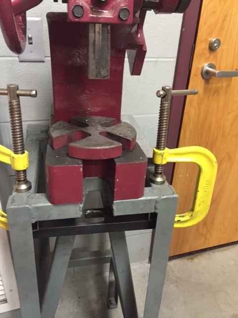

We ran into the same problem this year. Our temporary fix was to create a secondary press platform below the one on the press (we have one like this that lets us pass longer material through the bottom of the press.). We’d put the material on the secondary platofrm, press as far as we could go, then the broach would be far enough into the press that we could use the original platform to finish the job.
I hope I described that correctly. Just remember that if you do this, it’s important to make sure your secondary platform is parallel to the original platform so you don’t broach crooked.
That looks pretty much exactly like the one we have.
Could you possible post a picture of the setup you guys made?
We tried it yesterday and realized that the lower platform has to be attached to the press and not to the table where it all sits, otherwise the press just lifts up when broaching.

I’m in NJ for work and the press is in NH with the team. I’ll see if I can get a team member to post a picture. We have a custom steel stand that our press is bolted to, making things a little easier to attach.

If you do want to keep your press and use it with longer broaches and things, there’s two things you can do. You can chuck up the arbor in a 4-jaw chuck on a lathe and drill a hole into it, or you can build a custom table for your press, that has a sturdy place for you to set the part below the press.
this is the setup that 319 uses as Ty was explaining it earlier in this thread
