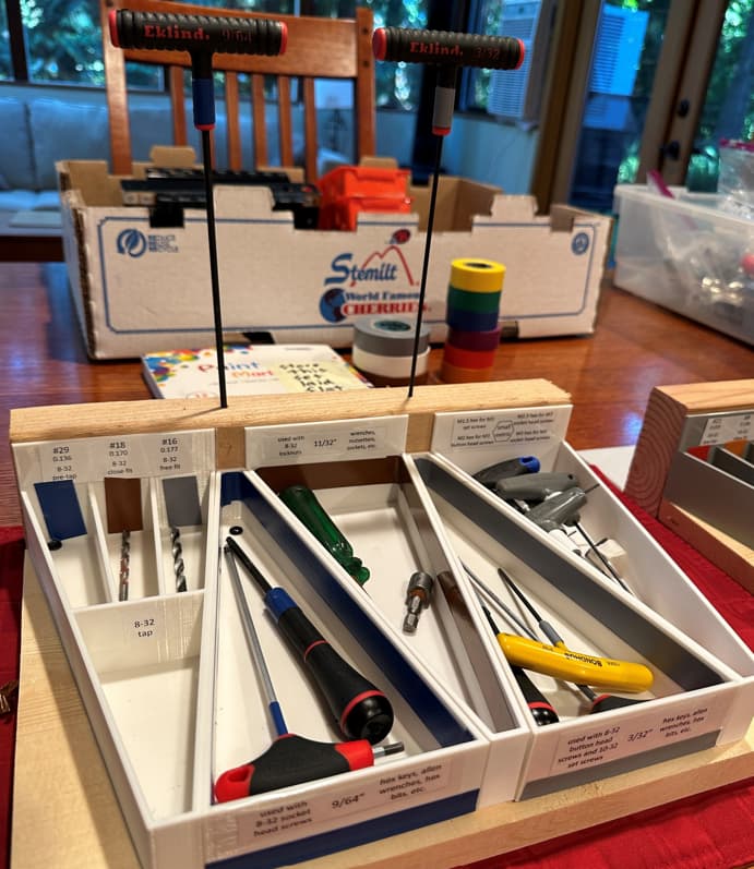

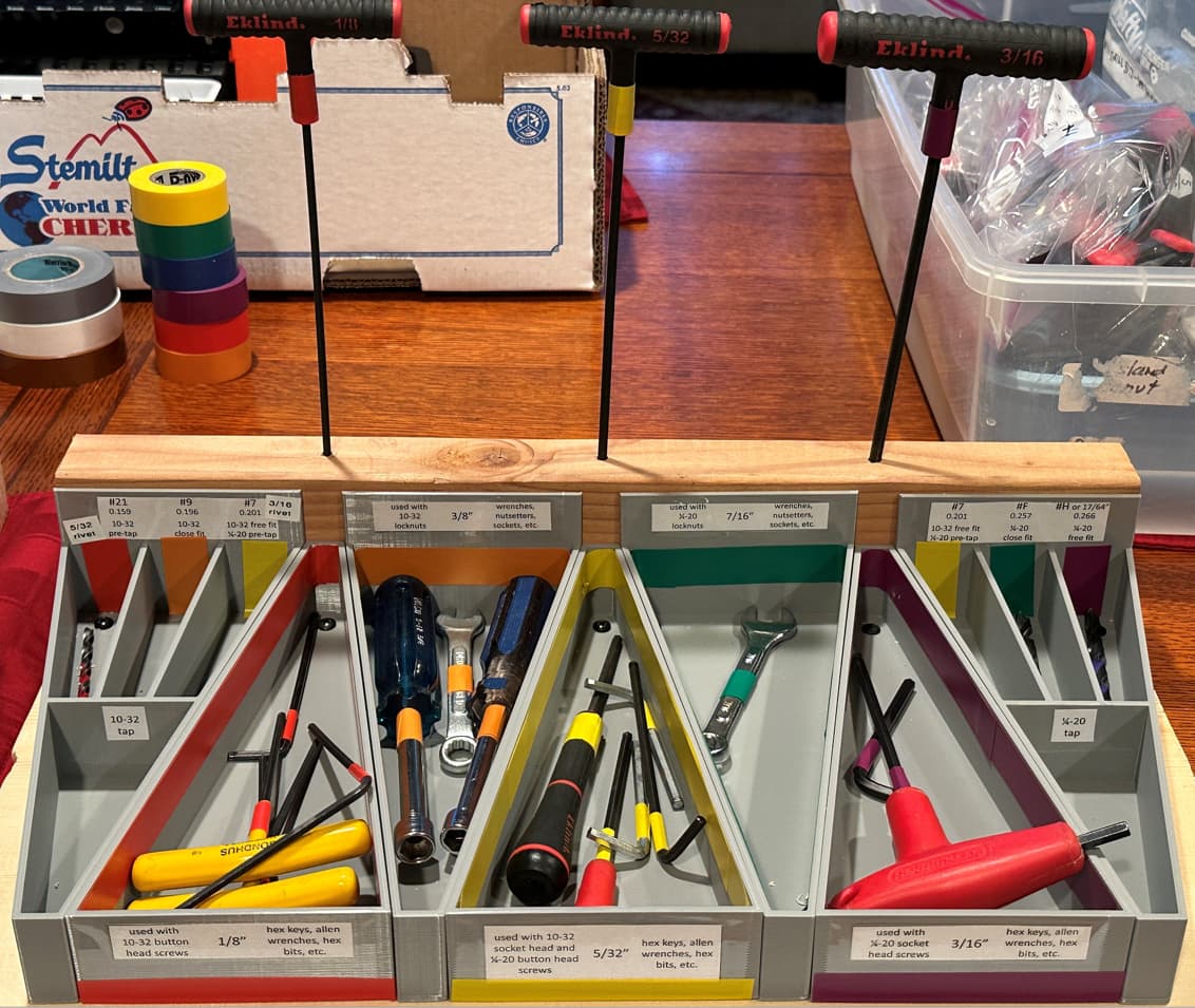

UPDATE 3: Added color coding associated with a new tool organization system I’ve been working on + pictures. The trays are designed as they are to fit within the size constraints of my little Ender 3 3D printer. A couple tools hang over the tray edge, but for the most part I think it’ll work.

Pictures of the color-coding / 3D-printed tray system:
Looks great! Only problem is if the Allen keys don’t get put back/mixed with the metric set
Working on that as well, inspired by this discussion. I’ll probably share my solution over there when ready.
