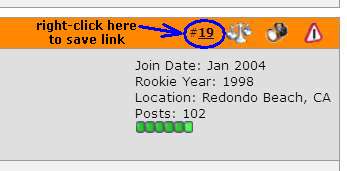

See Battery Life thread my 05-05-2011, 09:29 AM attachment (graph 50A discharge of FIRST 18AH SLA w/comments showing charge available in 3 areas of charge) BattTest50AchrctrznEX18slaGrph294-2006-1 crp30p.jpg
or PM me and I’ll email it.
Hi Dale,
Thanks for the reference.
Here’s a direct link:
