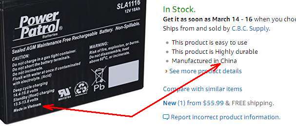

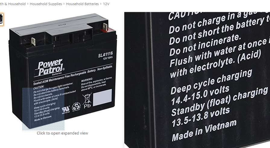

Edit: This Power Patrol battery and the AM one bank charger.
Hmmm.
If you don’t already have one, pick up a Battery Beak and check the internal resistance (at the bottom of the display), if your batteries have an unusually high resistance it might be time to replace them. Our batteries generally have an internal resistance of around 0.017ohms-0.024ohms, and get a floating charge between 13.8v-14.2v right off the charger (I actually even saw one as high as 15v once, but that might have just been a fluke).
Also keep in mind that SLA batteries loose roughly 10% of their maximum storage capacity every 6 months when stored at room temperature (even more if they’re stored without a full charge). As a general rule, we try to replace our batteries every 1-2 years (though some older batteries can be kept for demos, practice bots, and as “pit batteries”).
The picture looks like the one I have, which is not what the current Power Patrol batteries look like; I had to search five or six before I found one with markings that look like mine. I suspect the picture is out of date. (That doesn’t mean I trust Amazon’s text 100%.)
Edit: Yes, mine says Made in Vietnam.
