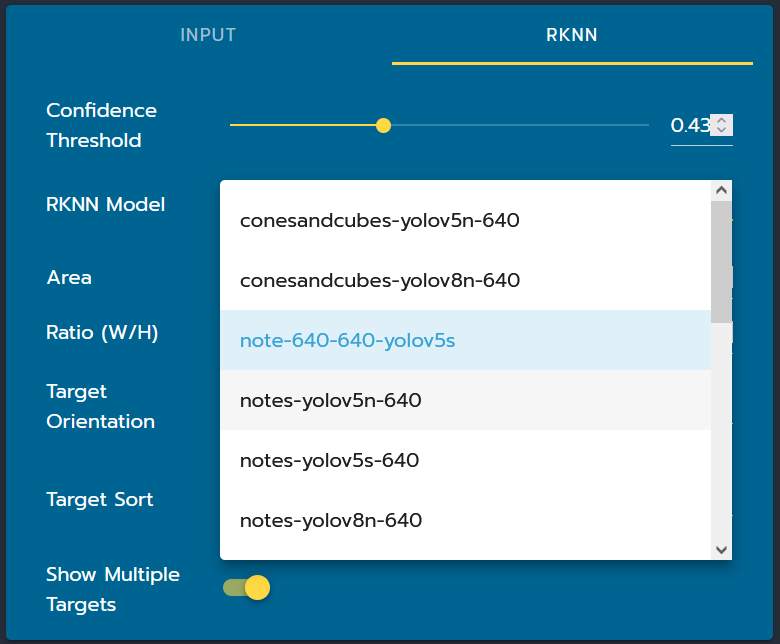

The main differences are laid out in the original post, but I’ll try to sum it up here in a clearer way.
Functionality wise, the main difference currently is that we support uploading custom models (that can be trained using the notebooks we made), of both YOLOv5 and YOLOv8, while the stock implementation supports only YOLOv5. Models can be easily changed using a dropdown:
Also, the stock implementation does not give you access to the confidence and class values from the robot code, while ours does.
The answer is both.
On the model side, we include a pretty good YOLOv5n model, in addition to the stock model that is now included with PhotonVision, and a lot of other models:
The model that comes with the stock implementation is note-640-640-yolov5s. Our YOLOv5n model is smaller and thus can run faster.
On the implementation side, when running the same model, the performance of our implementation seems to land at around twice that of the stock implementation, without sacrificing accuracy of course. If the PhotonVision team is interested in merging this, they can reach out via the Discord server, we’d love to have it baked in instead of maintaining a fork.
