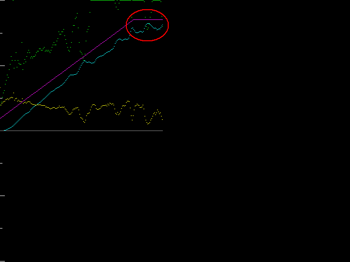

With the three averagers working together our encoder readings look like this:
http://www.termstech.com/files/test400_700.bmp
Where the cyan line is the encoder reading trying to match the magenta ramp velocity. Hope these ideas may help out.
What’s the time scale on the X axis? Looks like a lot of phase lag.
Each pixel represents a 10ms iteration… for completion, the green is the voltage applied while the yellow is the voltage scaler from PID (or actually PD). Notice how quickly the voltage peaks to full voltage… then drops when the encoder reading got too high… I cannot explain why it is trying to calibrate at a fixed offset below the desired velocity, but fortunately any issue of that would not be contributed to the averagers. I suspect that issue is due to the tolerance size (I’ll need to review the code).
*It doesn’t look like it’s holding the final speed very well (see portion circled in red). Do you have a screenshot with a longer time axis showing if it settles out?
Here same exact run… I fixed a bug in the graph program that allows it to process multiple bitmaps when the dump was too long so we can see most of it this time.
http://www.termstech.com/files/Test700_400.bmp
Hmm. Looks like 10 pixels (p-p) out of 229 pixels (full scale) = 4.4% p-p.
Tom is looking for 2% p-p (2674 to 2619).
The 4.4 is due to poor PID tuning and other mechanical issues with the shooter and should have nothing to do with the averagers giving the encoders a better reading… I could probably get 2.2 if I spent more time tuning the PID… which I did not have during the competition. I really need to find and post what the encoder readings looked like before these averagers were applied… unfortunately I do not have them on this machine.
The comparison you really want is your present filtered solution versus the true speed (as measured with a high quality calibrated speed sensor).
