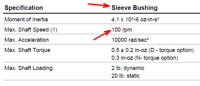

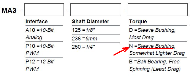

Also, it has a sleeve bushing and the rated max speed is 100 rpm.
The datasheet is available via a link at the AndyMark page you posted. Download it and take a look. You may not understand all of it, but take a look anyway. It’s a great way to start learning.

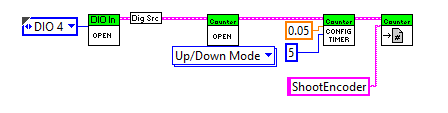

Just for future thread browsers, if that is the wrong way to do it, is this the correct way to count a one rev sensor as you suggest (obviously with some of the values changed)? It is similar to how we currently do it, and it seems to work well for high speeds. (Team476 example):
[strike]I do not have a LabVIEW installation, so you’ll need to answer some questions before I can answer yours.
Please post a screenshot of LabVIEW’s help file for CounterGet.[/strike]
I just checked Team 358’s excellent LabVIEW examples web pages, and it looks like CounterGet returns the period (seconds/count). So yes, that appears to be using the FPGA to measure the elapsed time between counts.
How exactly do you do it? And are you using a one-per-rev counter? And how high is “high speed”.
That’s actually an old 358 example from 2010.
You don’t need the Counter Start anymore.

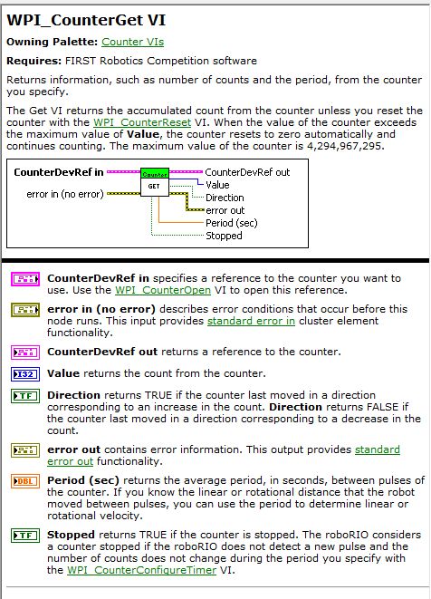

Here’s the Counter Get Help.
The period is the average of 5 samples in this example.

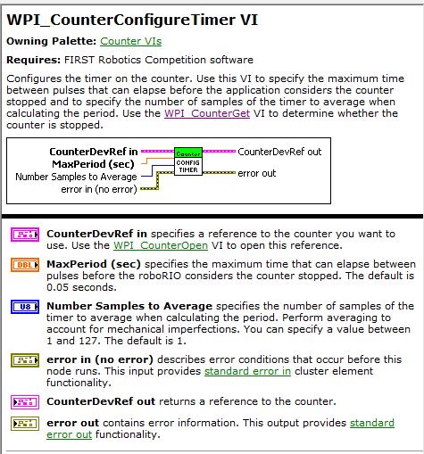

Thanks Mark. Where does it say 5 samples in that snippet? And how would you change that so it returns just the most recent period (which would be appropriate for a one-per-rev sensor)?
*I added the link in Mark’s original quote above.
The “5” feeding into the Counter Config Timer is the number of samples to average over, so just make that “1”.
In the original use of that example the 5 was meant to represent if you stuck 5 pieces of reflective tape onto your spinning wheel, so 5 samples represented a full revolution.
The example then drifted a bit over the years.

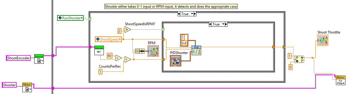

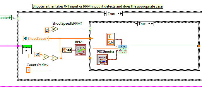

I hadn’t realized that the 5 for averaging correlated to how many ticks there were per RPM, thought it was just a sort of buffer. The setting used for 1 ‘tick’ is the “CountsPerRev” division after each counter get period (see attachment). We are running a shooter wheel off of a CIM motor between 3800 RPM and 5000 depending on our setpoints (still tweaking what works best). At full throttle, it reads around 5000, which matches up with what I would expect from a CIM motor.
It is currently a photoeye looking at 50% reflective tape, and 50% not, contiguously around the wheel. We are considering getting better resolution by breaking it up into 4 or 8 equally dispersed chunks, in which case “CountsPerRev” would be increased to this number when we read “Period(sec)” from the CounterGet VI.
The other cases shown are just overrides in case of shooter sensor failure to simply pipe a percentage value to the motor (detects a small setpoint, which means a throttle value is desired instead of RPM).

3800 rpm = 63.33 revs/sec = 15.8 ms/ rev.
If you are running your speed control loop at 20ms, you’ll get a fresh reading every iteration.
And, there’s an advantage of using only one piece of tape: there is no noise due to tape positioning tolerance since you are always reading the same edge.
If your CIM is geared 1:1 to the flywheel, you will not not able to control the flywheel speed at 5000 rpm. There is no voltage headroom for your control algorithm to work.
I use the *Number of Samples to Average *to account for placement error of the reflective strips. One full average always equals the same start/stop rising edge.

Good advice, we were not planning on running at 5000, closer to 4000 at realistic max. We have had around 30%-40% headroom roughly. I was just testing how fast it would go. It does seem to work with 1 tape segment, I just overheard someone in another thread suggesting more resolution for a similar application.
The averaging of samples to number of ticks in one revolution makes sense now, thanks! Of course, with 1 tick, having a few averages shouldn’t hurt, but really shouldn’t be necessary now that I think about it.
Now just to properly tune the PID so that it gets to the correct speed quickly without oscillation (hint to anyone with this problem, an additional offset added to the output can help get up to the proper speed range without cranking P too hard into oscillation territory) That’s tomorrow’s project.
