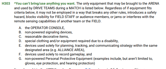

My idea would to integrate the screens from drive stations into holo lens’s to make the equipment lighter and provide data easier. The holo lens qualify for the safety rankings if I am right and are used industrially
You’ll likely run into the “non-powered” part of the rules if you are using the HoloLens as eye protection.

could putting saftey glasses under the holo lens say that the lens are used as devices used for tracking
Counter to this, looking into using nreal air for something similar to this, it is part of the “Operator Console” we got away with bringing extra computers no reason this would be any different it is a “screen” that happens to be attached to your face.
You could perhaps say it is part of the OPERATOR CONSOLE as long as you keep in mind the following rules about it:
I would not think you’d be allowed to use it as the only display as it would not be clearly visible in a match by anyone besides the wearer.

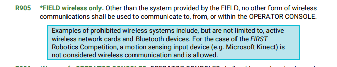

I’m not sure if you can communicate with the HoloLens over a wired connection. Maybe you can.
If your extra computers were not wired into the OPERATOR CONSOLE and didn’t fall into any of the other categories, you got away with a rule violation. As for the Nreal Air, you still have to wear safety glasses under them and they would have to be wired into the OPERATOR CONSOLE. Same as with the HoloLens, you would not be allowed to wear them before the teleop begins, so they cannot be used as safety glasses.
I’ve always thought this was cool but H401 and H402 get in the way. You either have to plug your headset into your laptop after auto ends or put on the headset after auto ends.
Wired we were very careful about it, wired over ethernet with some port forwarding fun to get our drivestations working across multiple devices without connecting two devices to the FMS

You’re right that the wording doesn’t say that specifically. And I prefaced it with “I would not think you’d be allowed” to more refer to that you’re going to get grief from volunteers. Though I would argue that since you can’t wear it during auto, and therefore cannot see it clearly, you would be violating the “clearly seen…in a MATCH.” I will admit though that the rules don’t explicitly say that the screen has to be visible during the entire match, so maybe just being able to see it during teleop is still within the rules.
