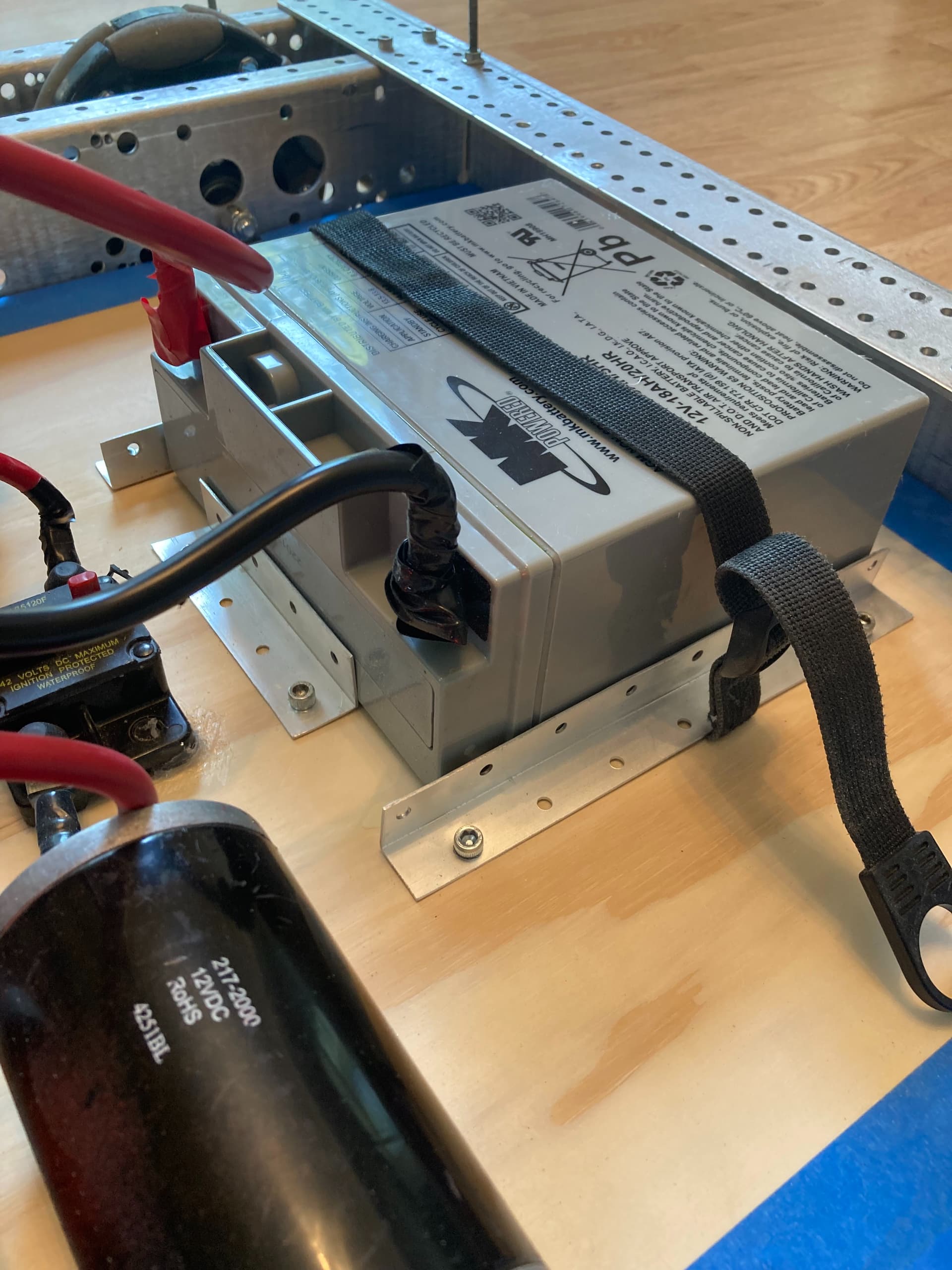

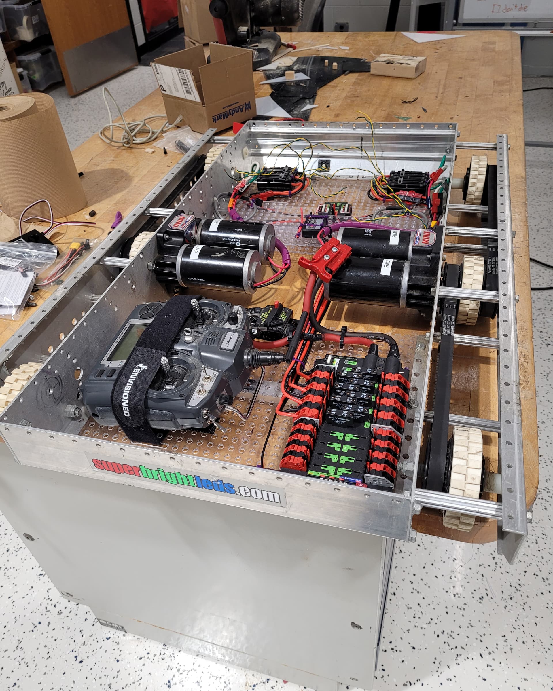

So generally a battery strap seems to work just fine. Essentially just bolt some polycarb into the robot as a base, and have some slots cut out for the strap. I would recomend other things to be placed around the place the battery actually sits to constrain it’s movements further.
Battery would go where the transmitter currently rests. This is subotimal positioning for actual robots, and not the lack of constraining blocks. The constraining blocks would be relatively easy to mount, just use wood or spare metal and bolt through it with some washers, sort of like this:
While neither of these show the KOP chassis, the principles are relatively easy to apply to other chassis.

What material is used in the base of the chassis? With holes.
The first picture I think is polycarb. The second I think is MDF. That was just a test chassis.
