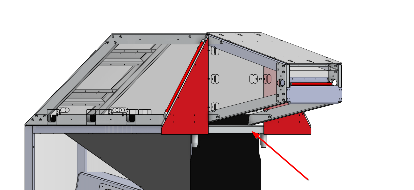

In comparing the wooden field elements to the Onshape model, it seems like there is a disparity in the horizontal distance from the front of the speaker floor bumper to the vertical riser at the bottom of the goal opening.
From the wooden model = 36.125" (10.25 front bumper gusset +55.25 floor beam -29.375 lower side wall width) OR from eDrawings 25.875 + 10.25 gusset depth (see pic attached)

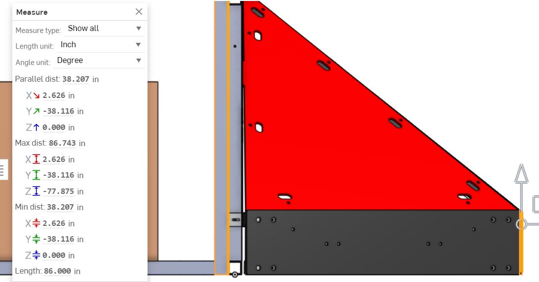

From the Onshape model = 38.2" (measured from front surface at field to vertical riser to goal)
I have not found any detail for the wooden models showing how the subwoofer (floor bumper assembly) attaches to the speaker goal assembly. I assume the floor beam of the speaker goal assembly just butts up to the subwoofer assembly and would contact the gusset that holds the 120 degree angle between the front and sides. The depth of the gusset would add 10.25" to the horizontal distance to the back bottom of the goal opening.
subwoofer assembly to floor beam
Can anyone clarify please.

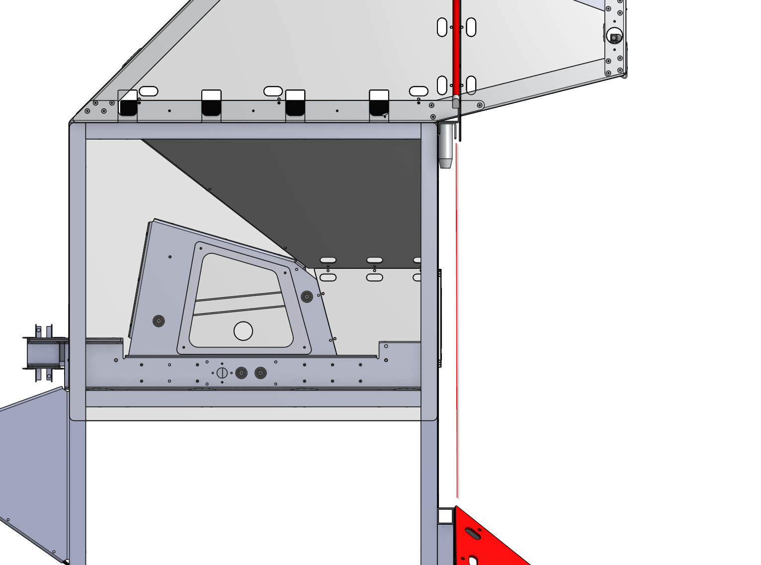

You can actually pull the models for the wood field into the real field to show this. We noticed the same thing and adjusted so that our at home versions would match the true field more closely. One thing to note is that the apriltags on the real field are inset of the field wall, maybe this was to help alleviate? We just adjusted both so they are in the correct spot.
I would recommend taking another look at the speaker near the top. There is a piece that runs across the goal (that holds the field together) and sets the front lower edge for the speaker this piece is inline* with the front aluminum frame. The april tags are the only thing set in from the front of the wall.
