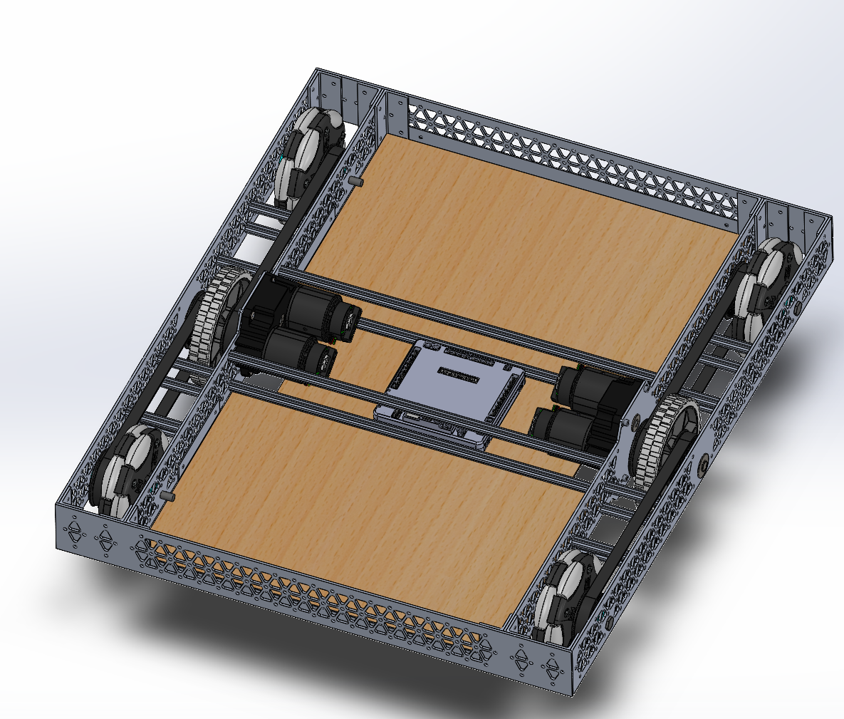

Hello everyone,
I just designed this chassis as an offseason project. Based on what you all can see, would this be effective in competition (IE not get eviscerated by a defense bot)? I understand the aspect that geometry plays into this (parts with 3D geometry are stronger than 2D plates), but I feel like I’ve done a reasonable job placing standoffs and brackets to counteract this problem. If there’s any good way to test this in SolidWorks, I would love to know.
Would love to see some feedback. Thanks everyone.
Hi! I’m not sure this is what you meant but I feel like it should be asked:
Can you defend your choice as to why this custom drive over a kitbot chassis?

Our programmers didn’t like the dropped center wheel of the KOP during autonomous.
This was also supposed to be a fun project for the team to do that goes a little bit outside the box of what we are normally able to make so doing things custom seemed like a good idea.
Unfortunately, this is a problem you will simply have to deal with. The drop-center is integral to having a robot that can drive properly, as it eliminates wheel “scrub” from the corner wheels. Center drop can be reduced by using omni-wheels on the corners, but a robot with perfectly in-line wheels(even omni wheels) will have a very hard time turning, which will make autonomous even harder.

OP: Your design looks fine, though most of the important constraints have little to do with how the drive performs and a lot to do with how easy it is to build, and it’s hard to judge that without knowing how you intend to manufacture this.

It is very kop-like, but missing the features of having bends in the plates, which do impart a lot to the strength of that design. If you have the ability to make long sheet metal bends that’d be an improvement.

OP, I like the drivetrain. My only issue is with all the L-brackets, which are always kind of finicky to get to fit tightly. You might want to look into tab-and-slot connections to make sure everything fits well. @Allison_K might have some pictures of fitting a captive nut into into a tab and slot design, which is cool.
This could be a minor complaint, but if you look at this design from the top, it’s made of rectangles. Rectangles are easy to make, but not particularly rigid. The bellypan is doing some good work to keep the big center rectangle in shape, but the outer rectangles that make up the wheel wells aren’t all that well supported, and might be susceptible to deforming like this:
If you attach those two plates with a flat plane (tab & slot attachment?), you can keep that assembly as rigid as the center part is. (As a bonus, it’ll also help to fix @ngreen’s concern with the sheet metal bends).
