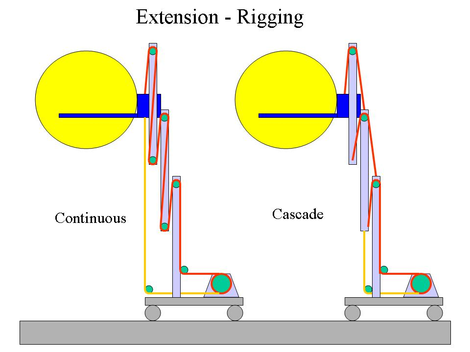

How are telescoping arms rigged?
My team is trying to design a telescoping arm currently and the biggest thing we struggle with is how it is going to be rigged. For my own design I just can’t find any good pictures of rigging that’s easy to assemble and fix etc. If anyone knows anything about them or any good resources that would be great.

Our team created a version this year that really works exactly like a cascade elevator. It uses 1/8" amsteel rope and pulleys attached to each stage of the tubing to extend the tubing or retract it with a winch system at the bottom.
This year we rigged ours with CF springs to extend and a winch to retract (climb). Springs are on each stage, and the winch cord is held in tension by spring force.

A couple questions:
  • Telescoping arm in the Pink (i.e. pivoting and carrying a manipulator) sense or in the simple, relatively low-load sense?
  • What are you trying to do with it? (Drop a hook? Climb rigidly with it? Move a manipulator?)
The rigging and bearing setups for a telescoping arm will vary widely from the answers to these questions.

It would be load bearing as it would be what our robot uses to climb, and it does not drop a hook.
Here’s how ours was rigged made of pvc and aluminum tubes
