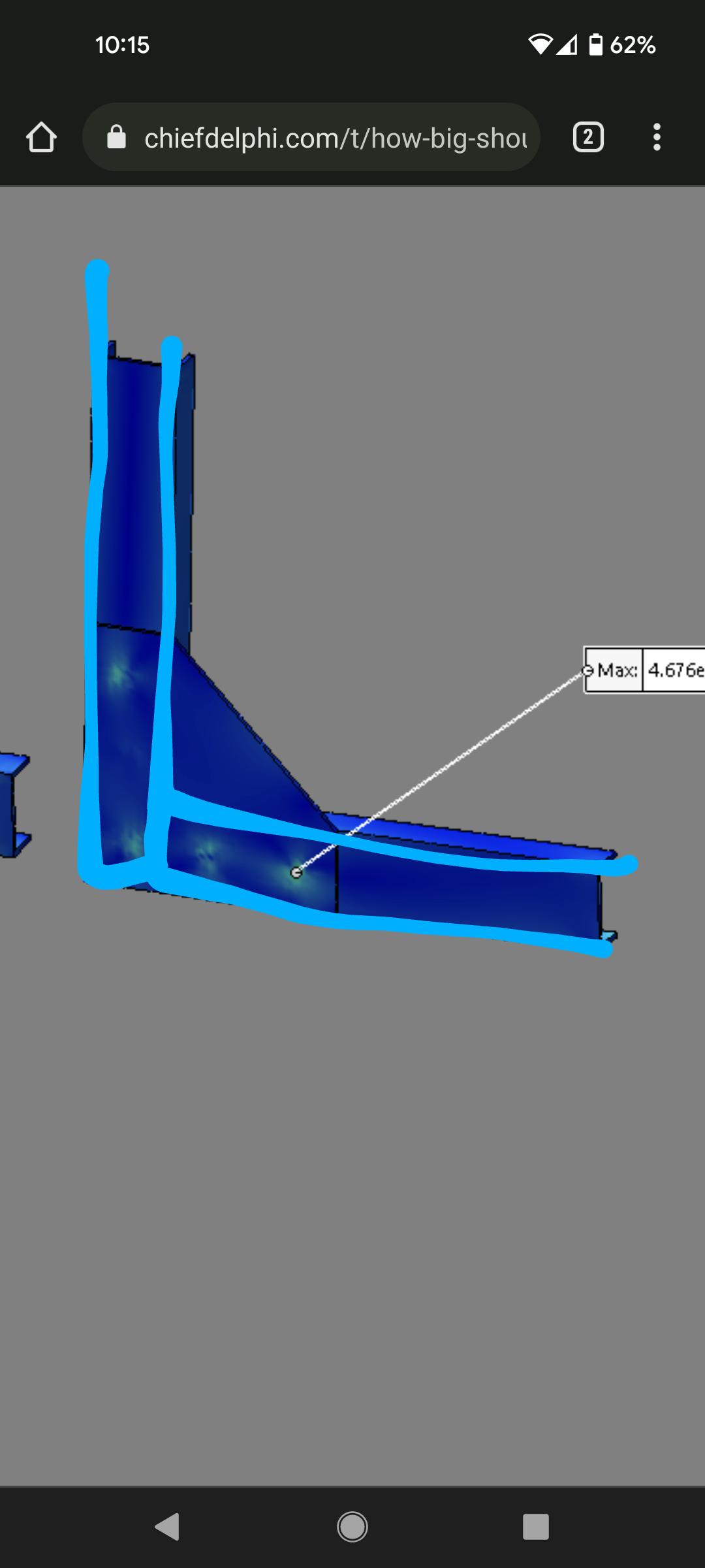

Some time ago @jtrv asked me to model corner brackets for 1x1 tubes to see how big they should be to strike a reasonable balance between size and strength. Here are the results!
3in → 4in bracket is a 43% stress reduction
4in → 5in bracket is a 38% stress reduction
5in->6in bracket is a 6% stress reduction
I would seem that a 5in triangular bracket is the right size range for 1x1 tube brackets.
Each bracket was modeled with a 3/16 spot weld at 1in-spacing as is typical of many FRC tube ecosystems. The spot weld is of course a simplification for whatever fastener might be used. It was not reasonable to model rivets or bolts (which are quite complicated to accurately model) for a relative-results type of model like this.
One end of the joint was modeled as fixed and a unit load was applied to the other end to bend the whole joint. Plane half-symmetry was used, thus the split bodies. SolidWorks Sim was used for this analysis.
Happy to answer any detailed questions and discuss other questions that can be answered with modeling.

Which direction is the joint lapped in each model? Like this?

Note the max stress callout location, your sketch is correct.
