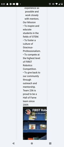

On your home page none of the pictures fill up the black box:

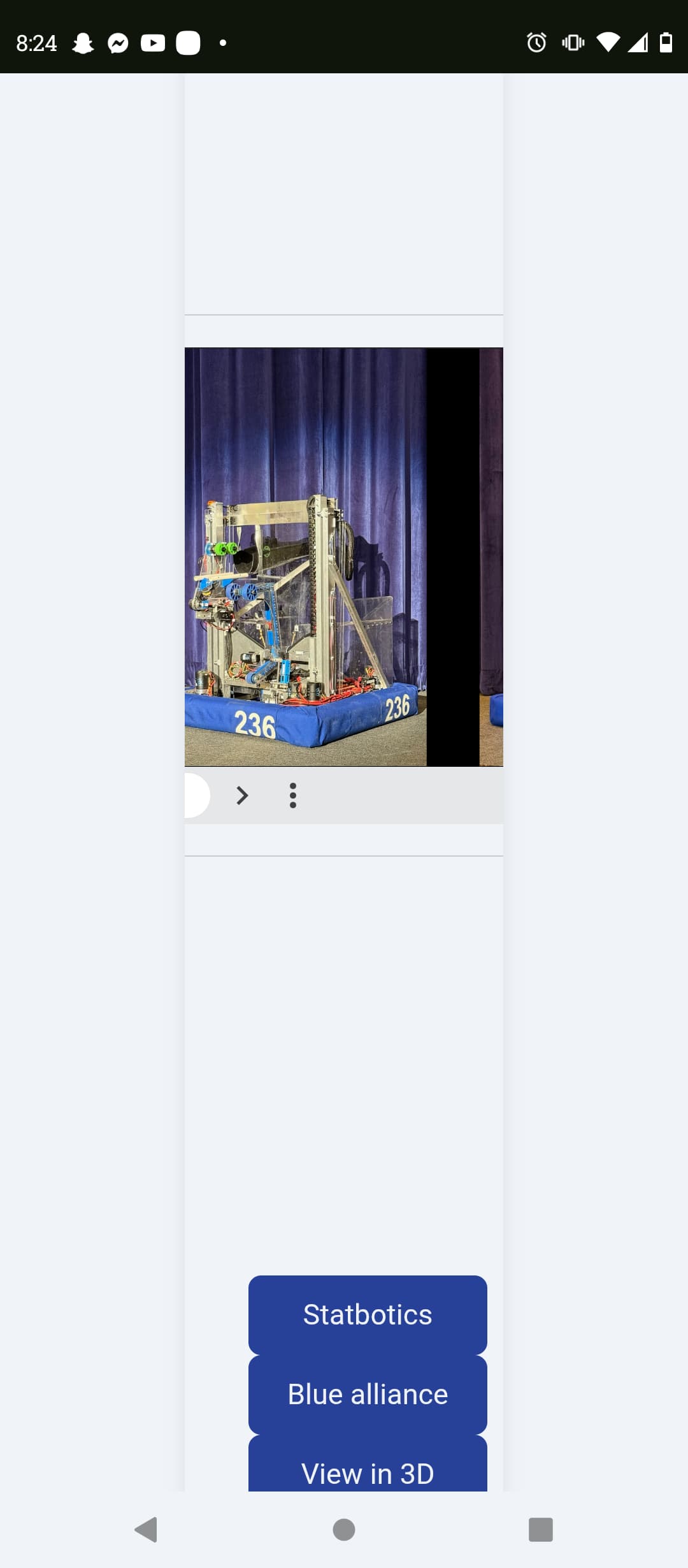

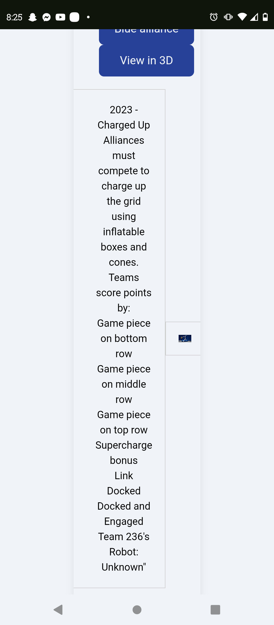

On your team history page the robots are either oddly cut off or when explaining the game as small as physically possible
In your about us page the YouTube video is oddly cropped as well

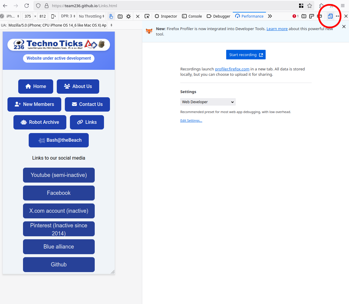

You can test mobile sizes on your laptop. Open your browsers developer console (ctrl-shift-i or right click and “inspect”) then find the mobile size tool. Here it is highlighted in Firefox:
Hey, another Firefox user nice to see it! I kinda knew this existed (as in I’ve seen the button before just didn’t know what it did), but never thought to actually use it, will do

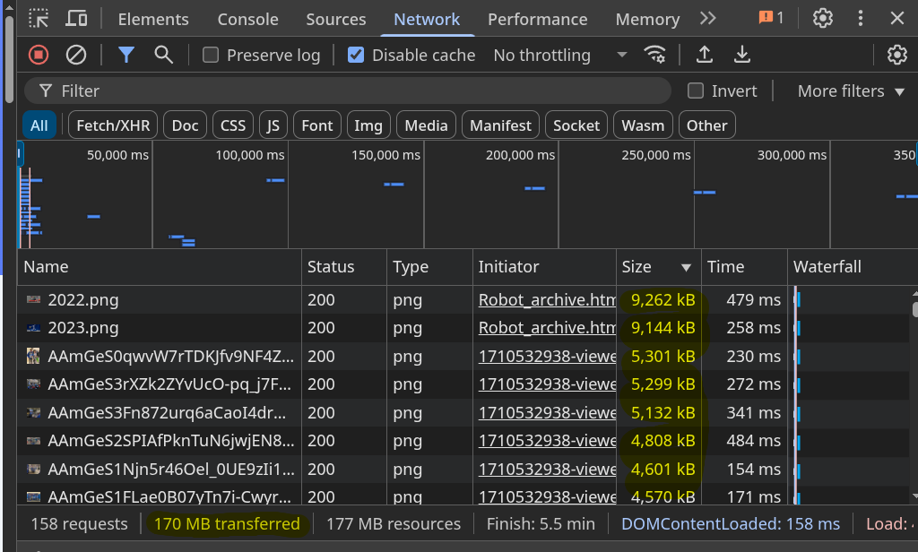

Still, there’s a TON of useful tools in any browser. In the Network tool, you can see the size of every single resource that your browser receives on page load. The Robot Archive page is particularly egregious: it’s pulling 170 MB due to all of those embedded Google Slides.
I would try replacing those with a button and a smaller, compressed copy of an image of each robot. Once you click the button, it will “summon” that particular Google Slides embed in the page. This will require some JavaScript.
Here’s another method: add the loading="lazy" attribute to each <iframe> tag. This will defer loading the iframe until it’s scrolled into view. This is automatically done by the browser: no JavaScript required.
