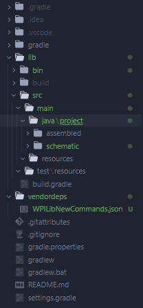

I tried that, still cant import anything in wpilibj2
Here is what the project currently looks like.
image_2023-05-31_163733191
Where’s the root build.gradle?
The vendordeps folder needs to be in the same directory as the build.gradle has the wpi.java.vendor.java() line.
So what I was initially doing was actually correct, I initially had them in the same directory but I had moved it in my earlier screenshot but what actually fixed the issue was far simpler. Reloading all Gradle projects :upside_down_face:. It only took me 2 weeks to figure it out of course.
