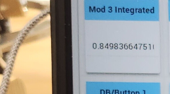

We tried that, but the value seems to change every time we start up the robot. Also can you explain the difference between integrated value and the regular value.

Do you mean integer? Also try setting all of the CANcoder offsets to zero then try again.
I ment this. We also tried to se the offset to 0, but the value kept going to 0.9, and the the wheel alignment was off.

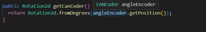

The issue is the getCanCoder() returns a value from the Neo and not the CANcoder. That means the offset is always applied to the value you are seeing in the dashboard. Either edit the function or set the offsets to zero and try again

Yea I just posted a screen shot of what i ment also i will look into the getCanCoder() . Thanks for helping
The code is bad so same thing as cancoder. Intigrates mean intigrates encoder.

Are you taking about this line because it is returning the CANCoder value
Sorry looking on mobile I could not see types. If so the code looked correct. You can take a look at GitHub - Team7520/UltimateSwerveBase: Custom Fork Of UltimateSwerveBase With NavX + CANCoder + Neo/SparkMax Support or its parent repository.
