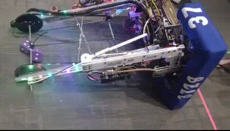

For 3729, from least priority to highest priority given to it in code:
  • Idle disabled pattern with our team colors (Red and White)
  • Light blue slide animations for when the arm is moving up and down
  • Blink pink if our pneumatics are not pressurized
  • Slow blink red when we have a fault (this is when photon is not connected, or a motor failed to configure for example)
  • Cube and Cone HP signals (Purple and gold blink)
  • And most importantly, party mode when we have detected we tipped
PARTY MODE

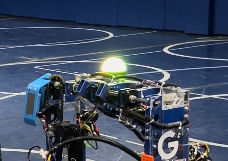

We’ve got a big ‘ol LED light from Banner - one of our sponsors - and it does a few things:
Human player things:
  • Solid Yellow: Cone mode (uses pneumatics)
  • Solid Purple: Cube mode (no pneumatics)
Other game stuff
  • 50/50 red and green: auto-balancing
At our first regional in La Crosse, we had a slight issue where our robot drove itself into the grid and the swerve modules burned holes in the carpet because our vision system couldn’t see the AprilTag at the start of the match.
We implemented a light signal so me (the Technician) can see if the robot is aligned perfectly at the start:
  • 50/50 Green and Purple: Vision is working & Cube mode
  • 50/50 Green and Yellow: Vision is working & Cone mode
  • Red: Vision is not working, do not enable so we don’t get carded

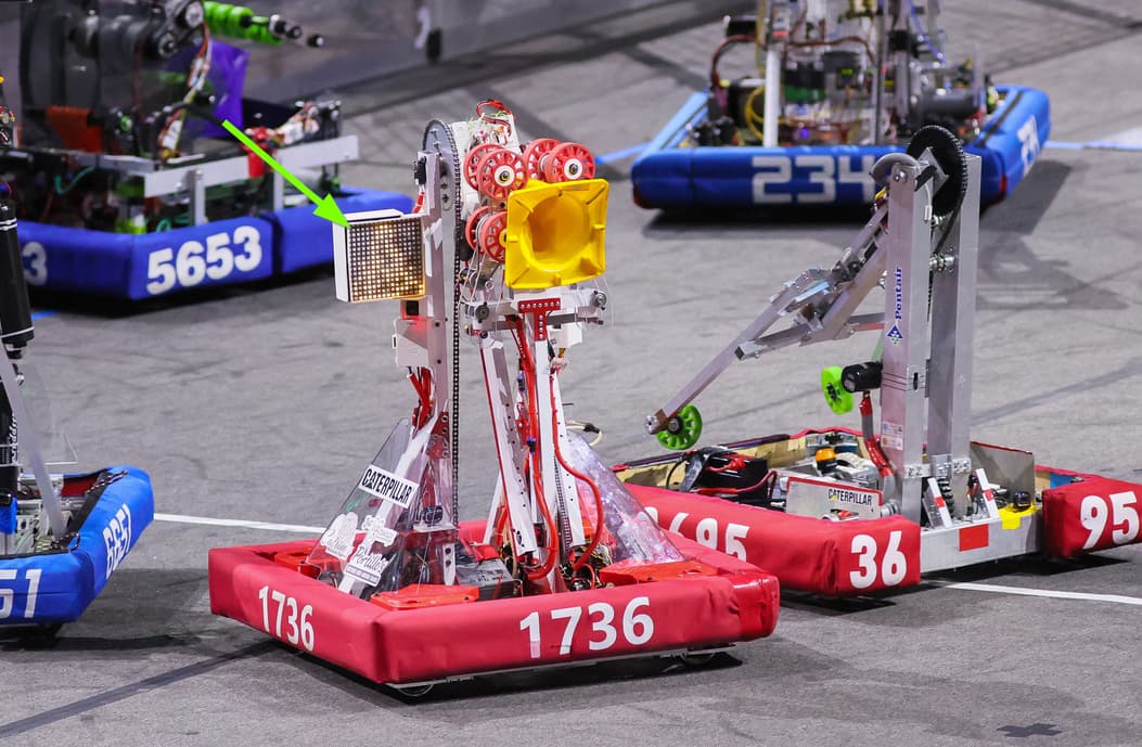

Presenting “The Jumbotron”
Yellow Triangle = “HP, please put out a cone”
Purple Square = “HP, please put out a cube”
Blinky Green = “Drivers, I have acquired a gampiece, please stop trying to pick one up”
Blinky White = “HP, you appear distracted. Please pay more attention”
Red team number scrolling with hat logo = “I am disabled”

What’s the part number and information for that big guy!?
We’ve got the Banner K90 series. We used a tiny circuit board to be able to plug our pins into the RIO so we can control the colors that we preset in the control software on a normal laptop. I’ll get more specs when I’m in the shop later this week, or maybe @Kadd can chime in as well
Thanks, looks like it’s too expensive to bring the idea to the team.
