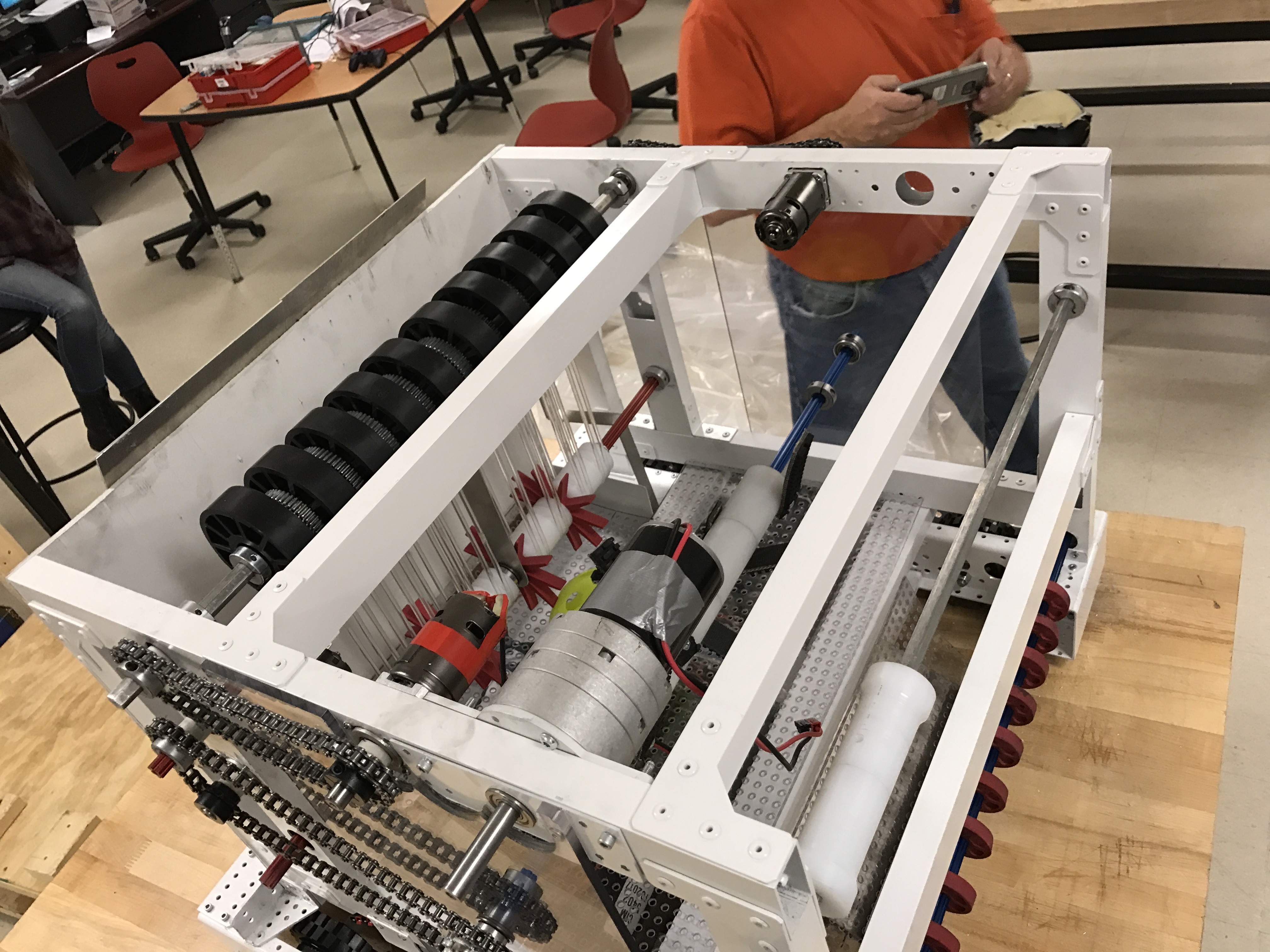

Our shooter, feeder, and bottom half of our hopper were all just over two balls wide. We had a very simple polycord belt for our feeder, and used gravity to funnel the balls from the top half of the hopper into the bottom half. We never had a single jam the entire season or off-season.
Thank you! You don’t potentially have a top down photo, do you? It seems like a simple and effective solution.

Unfortunately that’s the only picture I have access to at the moment, but I’ll poke around and see if i can find any more, or the CAD.

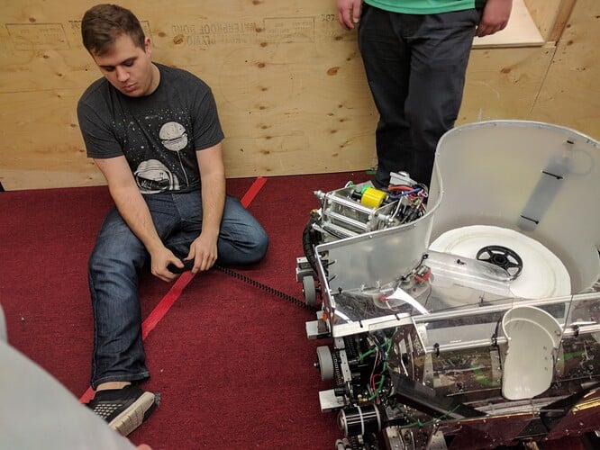

It was possible to get a high feed rate from a simple hopper. Our 2017 hopper had no 3D printed or CNC parts. It was just a spinning floor plus a carefully shaped outlet tube. The geometry took some iteration, but we got 5 balls per second out of it. We were one of only a handful of teams that managed to solo 40 kPa in competition.
Here’s a prototype video:
(despite that success, fuel was basically a complete waste. I’m still bitter).
A good shot of how the “spin dry” method works. Fun to watch too.
By far my favorite 2017 fuel hopper was the belt system used by 118:
I also just wanted another excuse to rewatch this incredible reveal. Not that you ever need an excuse…
This is pretty cool! What material is the floor made out of?

I think we ended up with currugated polyethylene (sign board) for weight reasons, but it could have been anything really.
