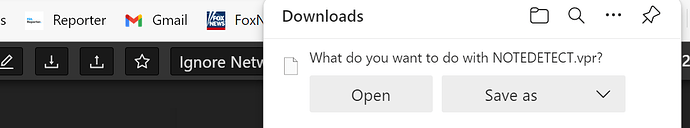

The Download button is for saving pipelines on your laptop. It also offers an Open option.
This is what I see.

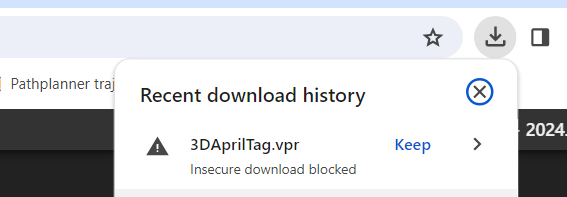

I finally figured out my “Download” problem.
I tried saving again, and this time a saw a flash up by the Chrome Downloads icon, When I rolled over it to see my recent downloads I saw this warning message
I just needed to click the “Keep” button.
Not sure what security protocol was causing this but it was very annoying…
