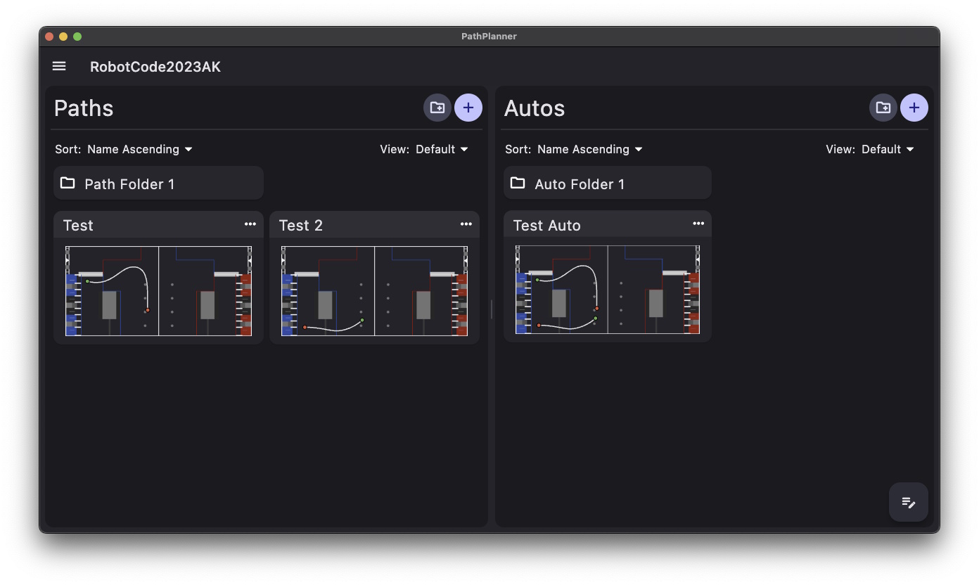

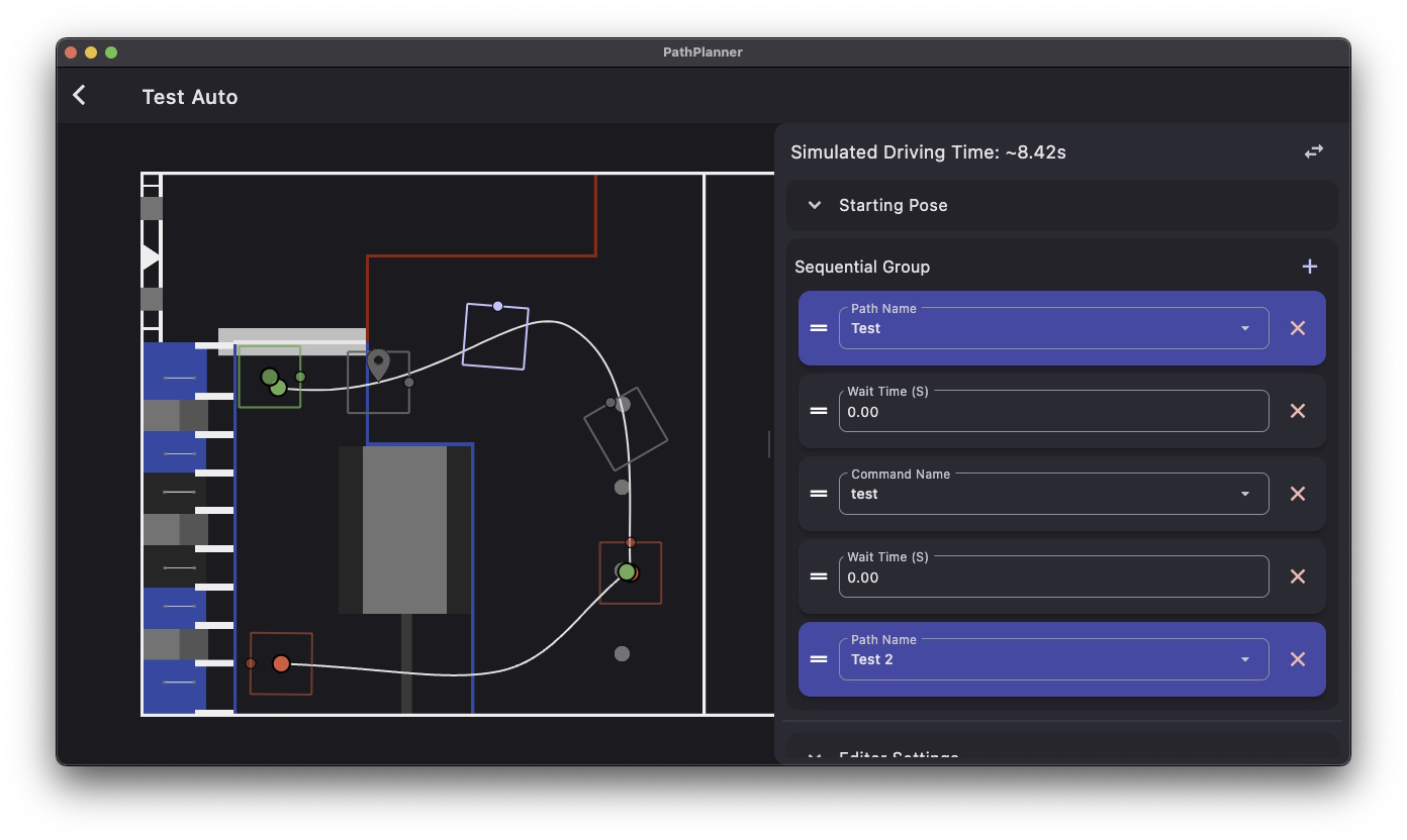

Me and my team use pathplanner for our autonomous routines but I cant for the life of me figure out how to open the auto menu, so much of the stuff on the pathplanner wiki seems to just not exist in my installation, I attached a bunch of pictures that are pulled straight from the wiki that I just cant find.

The wiki is updated for the beta version. If you’re using the 2023 version all the new stuff won’t be there.
Im using the 2023 version, is there a way for me to view the 2023 wiki? My team can’t update to 2024 yet
Bumping the comment above
The 2023 GUI pages aren’t available anymore unless you use the wayback machine. The 2023 PPLib examples are still there
