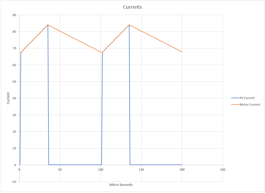

If folks are wondering how this can happen, let me see if I can stir the mud up a bit more.
This is a graph of Justin’s hypothetical motor. It is 2 cycles of the PWM chop @ 34% @ 10kHz. This is typically what you would see using fancy current probes hooked to an O’scope. The motor has to have a high enough inductance making the current continuous (verses discontinuous).
The slopes of the lines are dependent on the inductance of the motor, which I made up for dramatic effect (however this is close to what an RS775 looks like. A CIM is way flatter, which isn’t as dramatic).
The Power supply saw 75 Amps for 34% of the time and 12 volts 100% of the time.
The motor saw 75 Amps 100% of the time and 12 volts 34% of the time.
Of course, Justin already stated this, but folks might be asking “Where did the motor current come from if it isn’t connected to the battery for 66% of the time?”. The current comes from the inductance of the motor windings conducting through the intrinsic diodes of the FETS.
The best thing about this is we didn’t have to violate any conservation of energy laws in the process.
An important thing to remember is this “general rule of thumb” starts to fall apart as soon as the inductance of the motor or the energy pumped into the inductance becomes low enough that the motor current goes discontinuous, then it turns into a different math problem.
