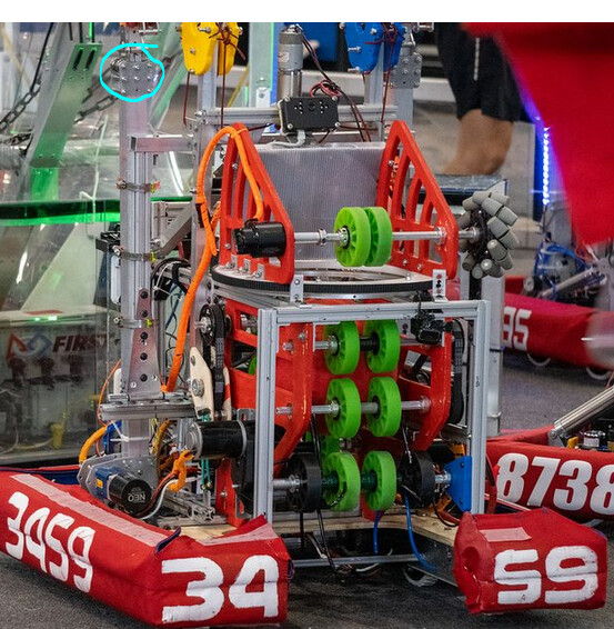

So here’s a video of one of our climbs, this one being from our state comp https://youtu.be/gVhUSxFySME?t=94 (3459 btw) and you’ll notice our climb is super slow, now we did have to swap the gearbox to a slower one because if we used a faster gearbox it would burn out the motor. So my question is how did other teams use the climber in a box faster (like this team https://www.youtube.com/shorts/8E2S2qKL-y4) without burning out the motor? The motor that was used was a neo and the type of gearbox was a banebox gearbox.

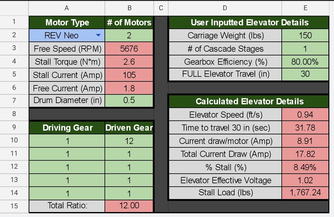

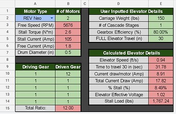

Here’s the calculation for our climb using the KLib Design calc:
You can see that with 2 NEOs geared 12:1, a 0.5" spool (wrapped directly on the hex shaft) can lift 150lbs while only drawing ~18A total.

-Reduce friction - I think this one may be your issue with burning out motors. There is a bearing slide, and a smooth slide on the climber in a box. The bearing side can reduce the friction more than the smooth slide will. Because of how you climb, and how you built the climber in a box, you are putting way ore load on the Smooth surface than you are the bearing, so you are probably getting a lot of excess friction. If you turn that 90 degrees, you will probably find that your climber takes less force to overcome the friction. This will speed up your climber as-is, and putting on a more optimal ratio will make it even more ideal

Yeah, we figured this out a while ago, the picture you shared was from our first competition before we changed it to be on the right side.
Do you have any current photos of your climber?

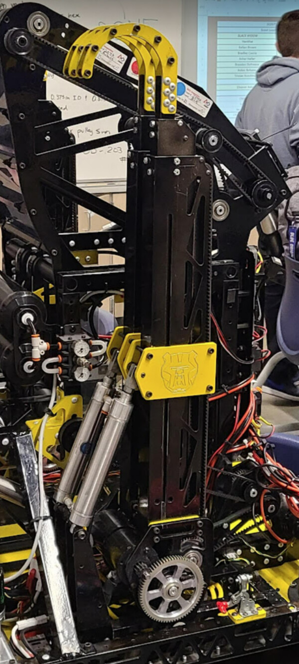

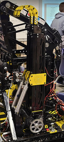

Using a faster gearbox is an easy way to make your climb faster. And turning up the motor speed if it wasn’t already at 100%. We used Banebots 16:1 gearboxes with Neos at 100% power with a 60 amp limit. We used these motors throughout the whole season and practice time (probably 100 climbs on them).
We also coated the arms in a generous amount of WD-40 before each match. Here’s our best climb before switching to pneumatics for actuating the arms. It’s 15 seconds from tarmac to traversal. We tried to be in the hangar zone at 25 seconds during competition.

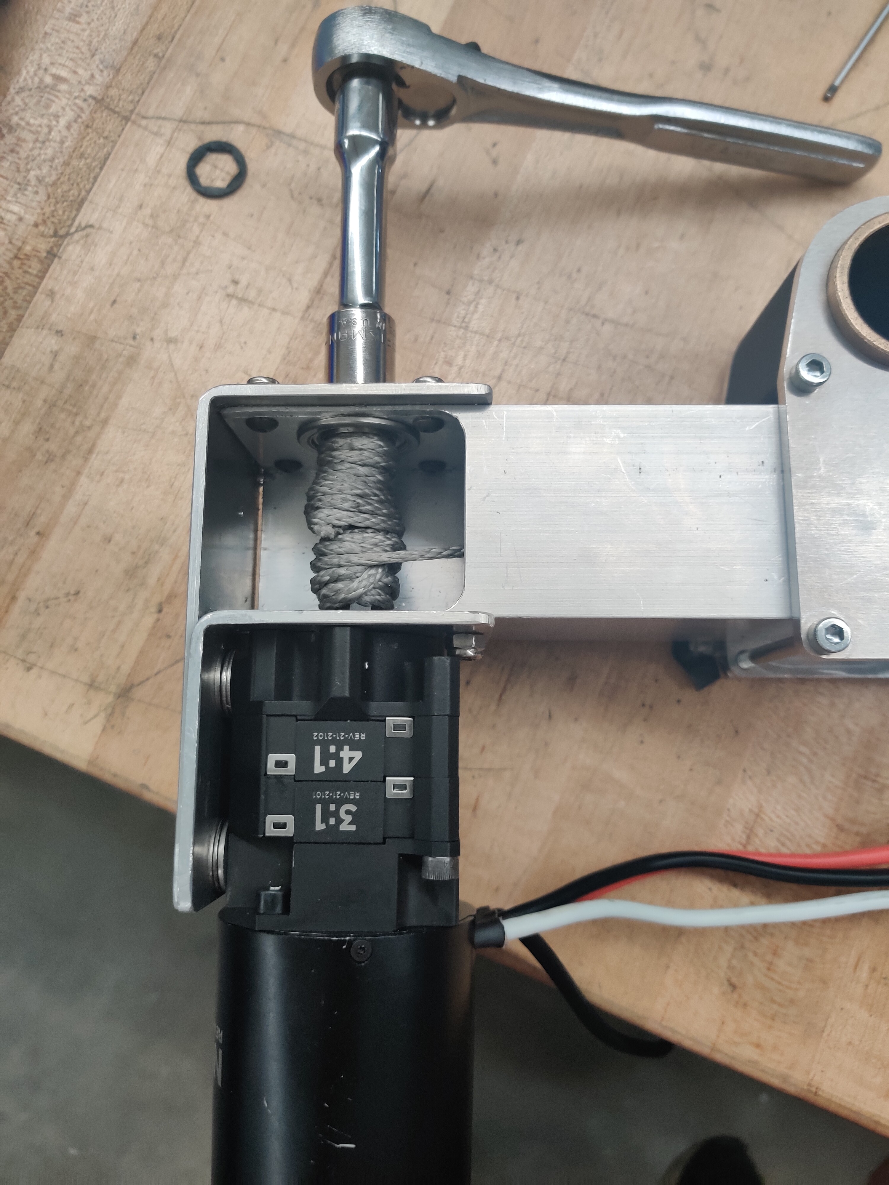

We used this silicone spray on our CiaB tubes every few matches as they picked up some debris and slight dents in the tubes from match play. They would move just fine, but the tubes wouldn’t always come out at the exact same speeds or time, and this was important for us as we kept pushing the margin on climb speed this year.
