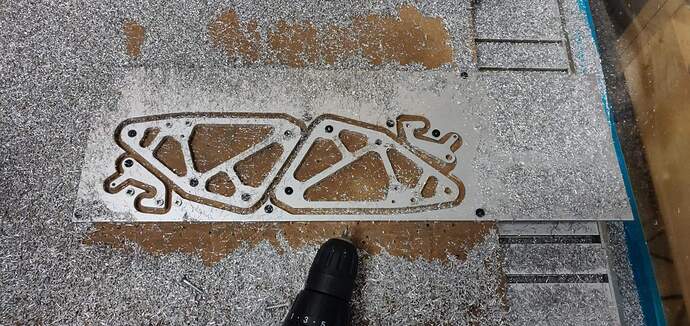

It would be best if you sent a pic of your set up, but for us we screw most of our parts to the sacrificial board so that we don’t need to use tabs. Work-holding is definitely dependent on the situation though.

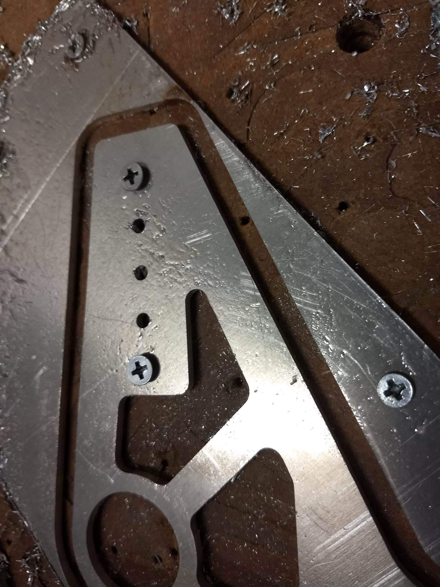

If you want something Fancy you could still use a vise and machine the internal features first, including mounting holes. You can then machine a sacrificial piece to hold your part down that matches up with the mounting holes. After that simply fasten your part to the sacrificial plate and machine away the excess. If you fully remove the extra material as chips then you don’t need to put in extra mounting holes to hold it down. If you only want to contour around the perimeter of your part with a slotting style operation then it would be wise to put a few fasteners through the scrap areas so they don’t go flying. An unsecured piece of material that contacts a cutter can go flying and can also damage the endmill/cutter! With a sufficiently slow tooth speed this can be less of a concern but it should not be a game plan.

Some people get fancy with drilling/tapping holes for fasteners but that’s a lot of effort. I use parallel clamps to hold the stock onto the sacrificial plate. Others have mentioned it, but I also tend to remove all the material for internal pockets so no small bits are thrown. Tabs around the outside contour are more then secure (outside is machined last anyways).

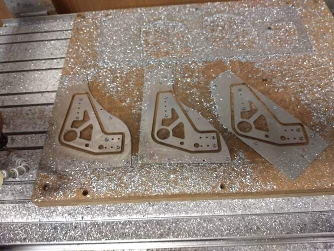

We have MDF mounted to our table, and we screw our plate stock down to the MDF.
Then run a pass to drill holes in each of the parts and any scrap pieces which we screw into place. Final step is to cut the profile for each of the parts.
