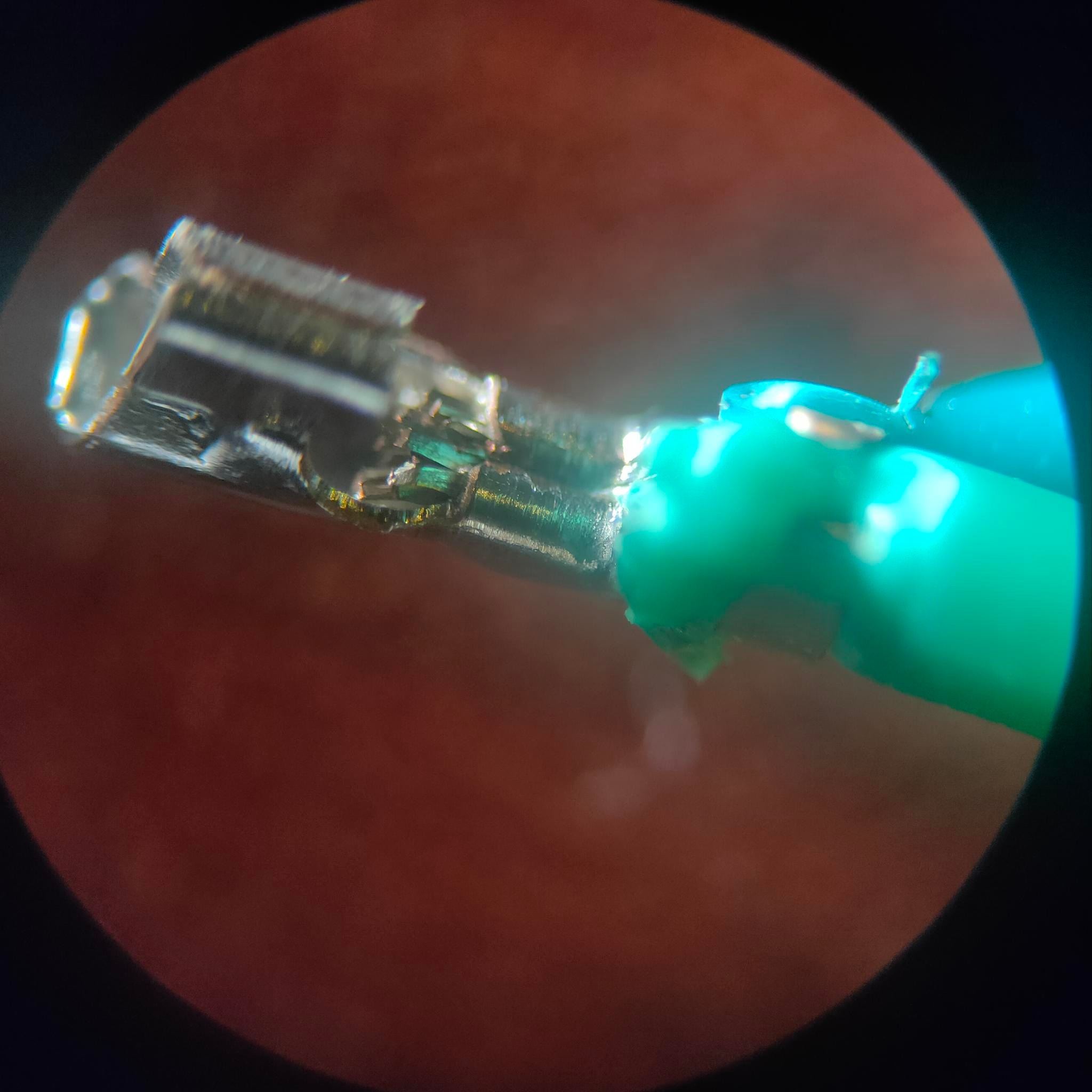

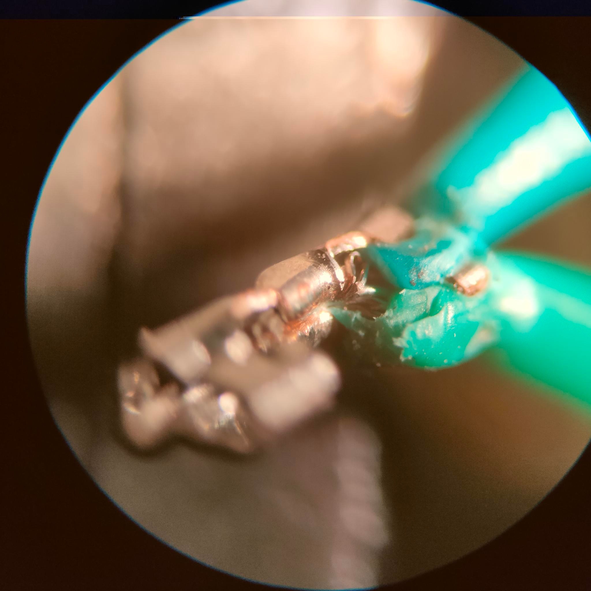

I’ve managed to remove a crimp from one of 3494’s REV Spark MAX CAN Cables and get two serviceable pictures with my toy microscope and smartphone camera.
The light-green wire is the CAN wire, and the dark-green one is the loop wire.
I see two tricks that REV used to make both wires fit into the one terminal:
  1. The loop wire is only 26 AWG. This makes the total conductor area in the crimp 0.129mm² + 0.326mm² = 0.455mm², which is only a little more than double that of the largest single wire the contact is rated to fit, 0.205mm².
  2. They just cram the wire in there. The conductor doesn’t seem to be the limiting factor; strands from both wires are in the crimp, and the conductor crimping barrel looks to be well-formed. Rather, the insulation is the limiting factor. There’s so much insulation that the supports can’t actually go around it all; both of them actually cut into the insulation, then poke back out before bending over a bit. (I wonder how hard it was to set up an automated crimper to insert the wires like that?) The wings are also definitely not bent over as far as they’re supposed to be, but I can’t judge how tightly they’re actually holding on to the insulation.

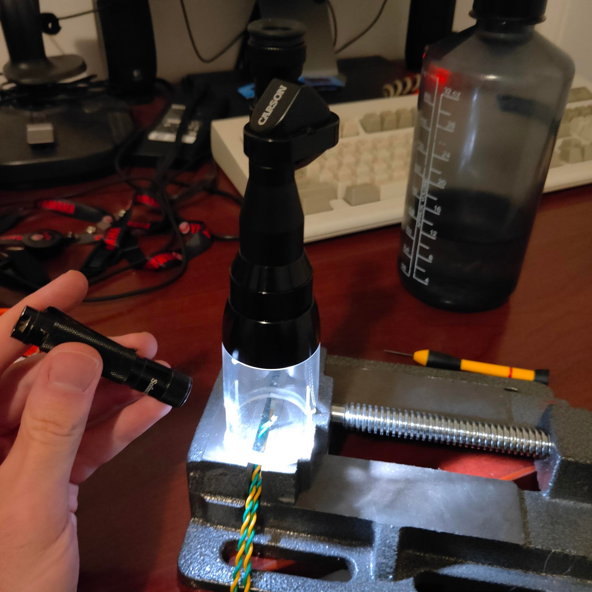

picture of my setup
Just imagine me using my other hand to hold my phone over the microscope, focus, and snap the pictures.
The vise is just keeping the wire from moving around; it isn’t actually clamping down on anything.
edit: I might try to get access to a better microscope to get some more, better pictures.
