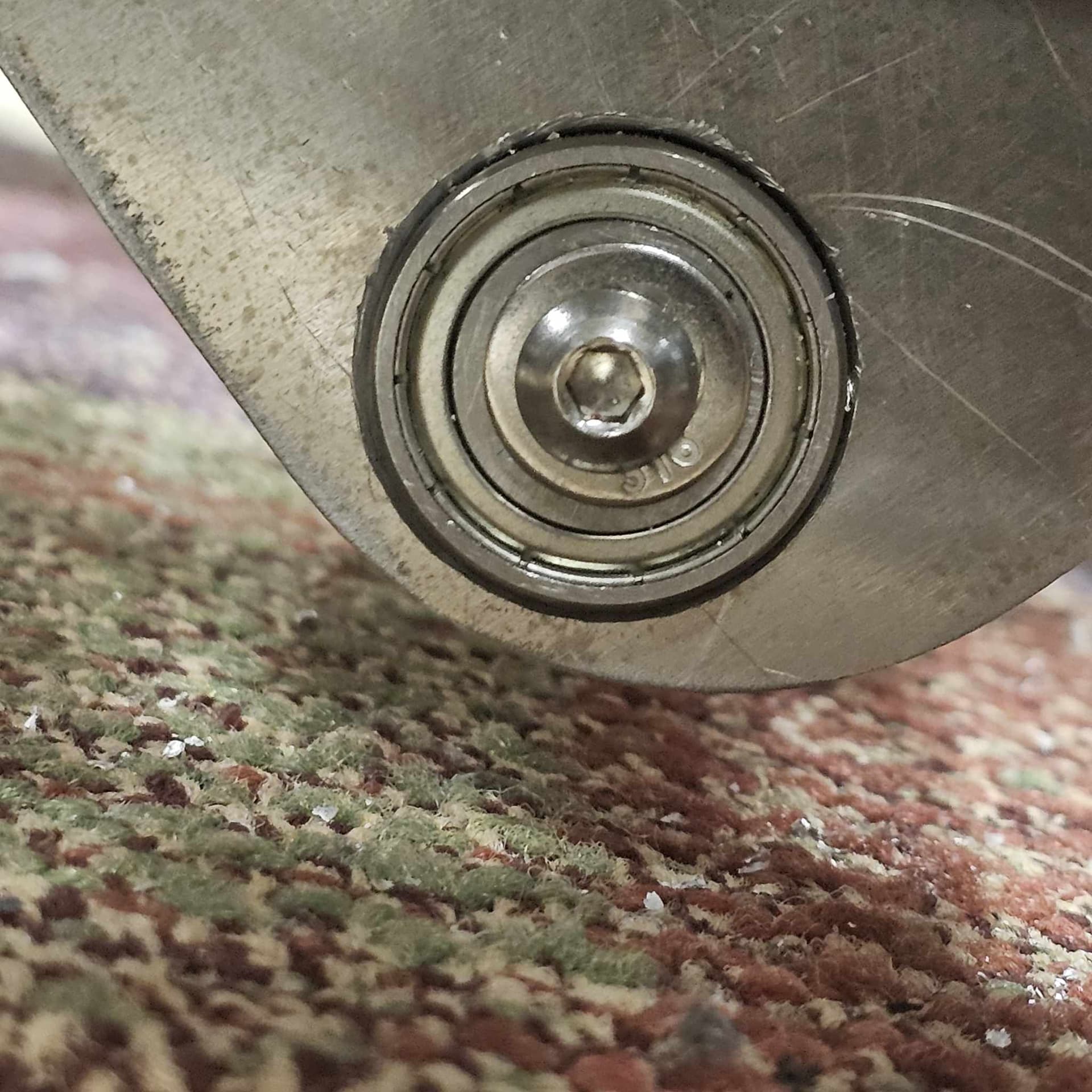

We are trying to retain a bearing from coming off of a bearing mount plate. How do you keep it secure so that it won’t slide off? (We don’t have rivets)
We have done a couple of different ways over the years.
1.Shaft Colors or spacers to hold it in.
2. Drill and Tap Shaft, bolt with a washer that has an OD that matches the inside of the bearing.
3. Use 8-32 or 10-32 Screw heads to hold in the bearing.
Assuming the shaft goes across to another bearing on the opposing plate, you can cut & sand the shaft to the exact length so that it is flush with both bearings. Then if you tap the center of the shaft on both ends, you can install a screw and washer and this will retain the bearings and shaft
If you don’t have tapping capabilities, you can also cut the shaft a lil longer and place shaft collars on both ends

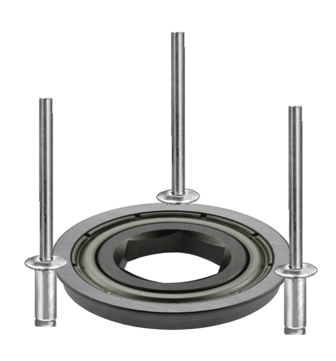

here is the easiest way to do it. Been doing it for over a decade. Would advise going to any local hardware store and getting rivets and a rivet tool. Will cost like 20-40 CAD for a rivet tool and 8 CAD for a 50 pack of rivets

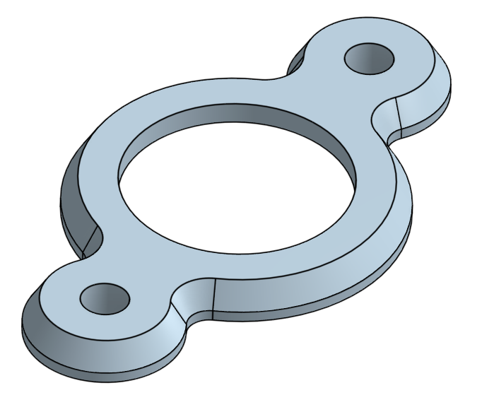

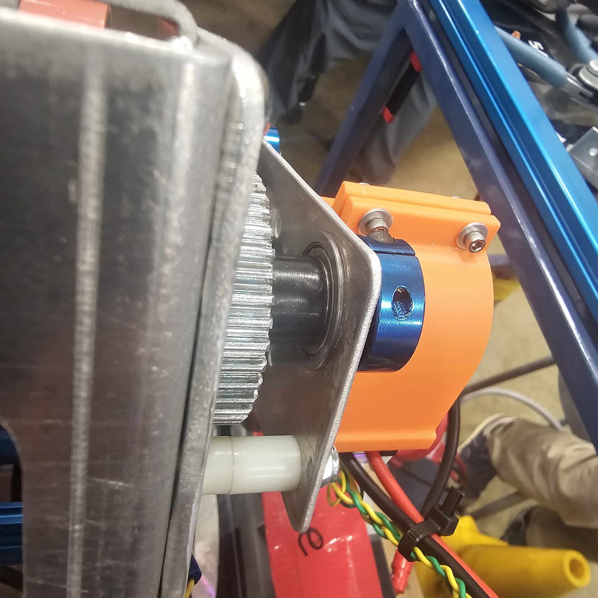

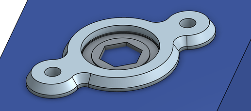

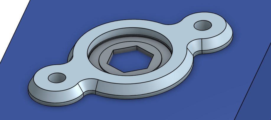

Yeah we use a similar thing to the WCP bearing mounts, it’s 3-d printed with regular PLA, but holds the bearing down quite well. We have updated the design over the last 2 years. We use 2 #8-32 hex or button bolts spaced 2 inches apart to hold it down. Here’s the stl: bearingHolder.stl - Google Drive.
Take a look!
OP: Seriously. An inexpensive riveter and some rivets is an excellent investment. Rivets are far, far, faster to deal with than screws.

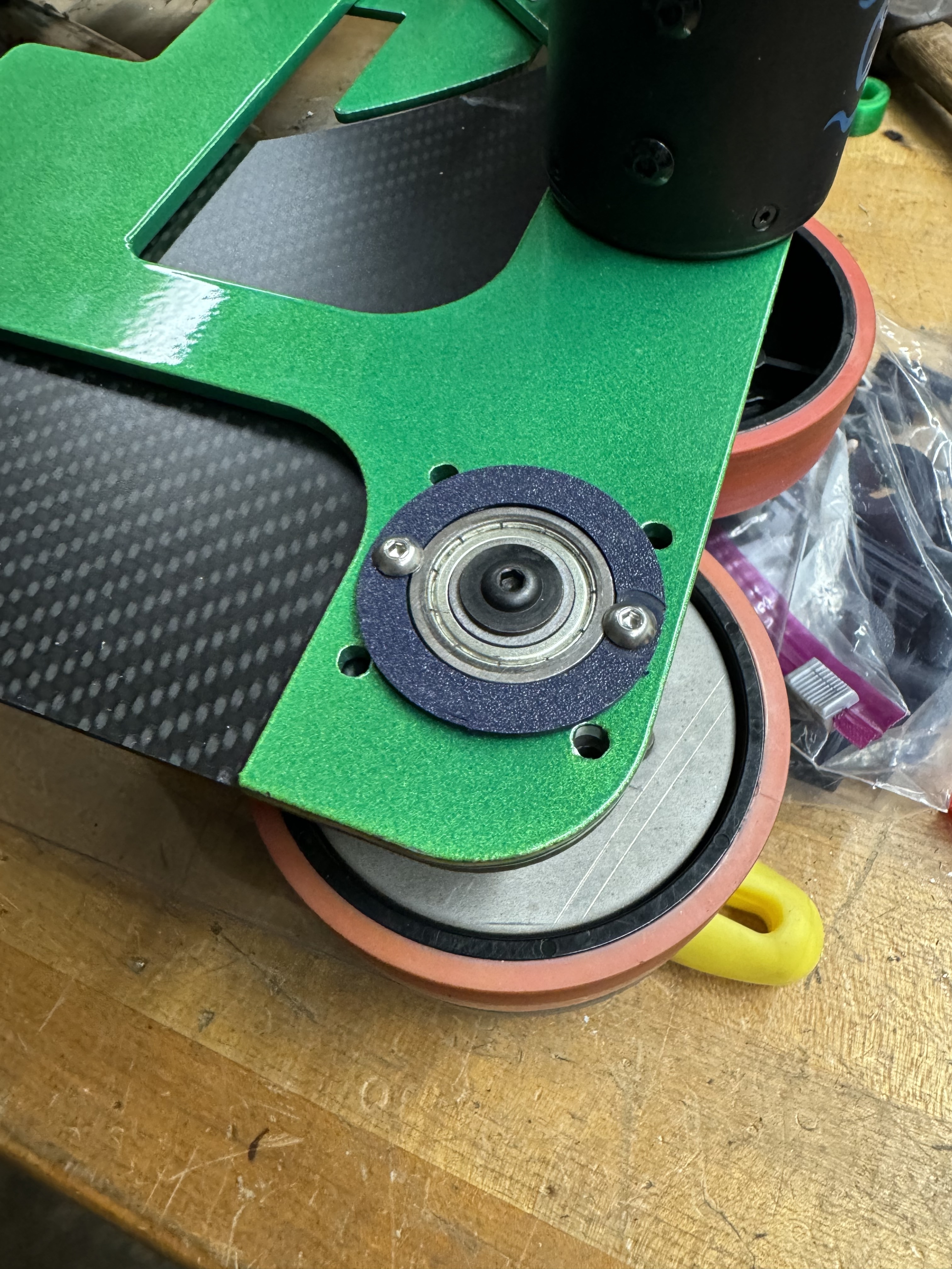

This is how we do it on our robot this year.
