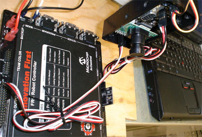

Would photos like those posted here help? I could take a few more showing additional components like the RC and servos connected.

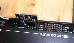

Here are a couple of other photos to help. The servos are driven by the camera by those wires at the top. We had to reverse how the camera drove the servos, but you cannot quite see the jumper used in the photo.
There are two different ways we hookup the CMU camera:
  1. to a PC to run the CMU GUI to get the calibration numbers and to test the camera. At the regional events the FIRST staff will give you the calibration numbers. These numbers have to be typed into the CMU camera code (v2.4). The GUI is in the IFI Robotics download
    http://www.ifirobotics.com/docs/cmucam2-documents-and-software1.zip
    You’ll find the GUI under the folders Software\CMUcam2GUI_fe\stand_alone and is called CMUcam2GUI_fe.jar
  2. to the RC to drive the robot.
You cannot have the camera hooked up to both the PC and the RC at the same time or it just won’t work.

if i dont hook up the ttl port and the pwm cord to the rc controller then i dont get any pwer, why is this?
The camera draws power through the cable connected to the RC pwm output.
The PWM output power is only supplied by the small backup battery attached to the RC.
Only the center red wire of the PWM cable is actually used. The camera doesn’t care what the PWM is set to in the code.
Yea i noticed that too, the cam wouldnt work without the battery, i read over the manual again to see if it provided that we needed anything else, and there it was… you need the back up. Hooked it up and the lights went on I was happy :slight_smile: .
Couldnt have done it without you Mark
i realized that i had put the pwm cord backwards and thats why it wasnt getting any power. lol.
