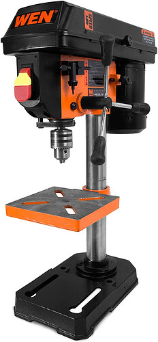

First of all, you NEED to be using a drillpress for such tasks if you are not already doing so. It will be extremely difficult to hold a hand drill precisely enough to get the results you are wanting.
Make sure that the table of the drillpress is set as high as practical. Having to extend the quill more than necessary will allow it to wobble around more.
Make sure the table of the drillpress is perpendicular to the axis of the cutting tool. There are many YouTube videos showing how to do this.
Make sure the rpm of the cutting tool is not too high i.e. large diameter = slow rpm. When the linear speed of the cutting tool is too fast, the tool chatters and vibrates, causing the axis of rotation of the cutting tool to wander around. You may have to pause and change the belts from one groove to another but the results are worth it.
To get any sort of precision and repeatability, you MUST clamp the workpiece onto the table of your drillpress using at least 2 clamps, one on either side of the cutting tool. Allowing the workpiece to move relative to the center of the cutting tool will lead to imprecise and inconsistent results. Clamping the workpiece is also a safety measure, especially when using large diameter tools. When a larger diameter tool catches on the workpiece, it WILL rip it out of your hands and spin it around like a lawnmower blade.

  2. Bench top drill presses can be purchased for as low as $86 (Wen is $86 on Amazon) which means they are within budgetary reach of nearly every FRC team. These make it much easier to drill 1.125 holes safely and accurately when a gusset won’t suffice.
