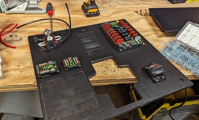

Battery placement is usually baked into the design pretty early on since it affects mechanical access as well as center of gravity. From there we typically layout components roughly in CAD, starting with the PDP/PDH and breaker since those needs to be in relatively close proximity to the battery and have stiffer cables. Then we’ll place motor controllers near the PDH, then RoboRio, VRM, PCM etc.
Once we have a rough layout that looks in CAD and some of the mechanical parts of the robot are prototyped we will lay out our physical components on a board on the robot and make sure that still makes sense, and then turn that into our final electrical panel by fine tuning the CAD before making final parts. The last step isn’t necessary, but does make for a more polished electrical panel.
That addresses the bulk of the electrical components, but during design the mechanical team is also looking at wire routing down into our drivetrain, up into any payload, through superstructure etc. Since this moves pretty quickly we are generally doing things like popping large access holes, and doing best guess, not really modeling the wiring. Wiring lengths and final routing are determined when we hook up our panel, and refined during testing leading up to competition (s).

Rough layout in CAD that we tested and lived with for a few weeks, then panel as finally fabricated.

What worked well for several of the teams I have mentored is to install the control system components (electrical and pneumatic) on sub-panels. This allows construction work on the mechanical structure and the control system to proceed in parallel.
Once space has been set aside in the design for the control system, the sub-panel(s) are cut out. The layout of the components is developed, allowing space for wiring channels. The components are installed and connected. This allows the control system to be pre-tested before being installed. The pre-testing helps eliminate silly errors like motors turning in the wrong direction.
Since the detail design and construction of the electrical sub-panels occurs in parallel with the detailed mechanical design and the construction, more time is available for the electrical design and construction.
