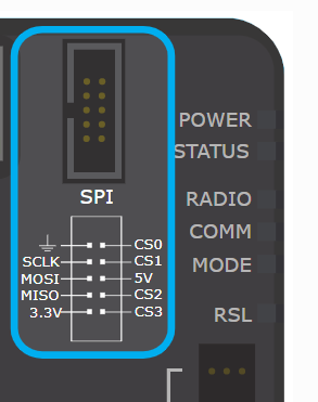

This page has details on hooking these up. The roboRIO has SPI on a dedicated 10-pin connector, and also on the MXP expansion port. Note that the roboRIO SPI pins are 3.3V, and the LEDs are spec’ed for 5V SPI. I can confirm that if you hook things up in a way that follows the bottom picture on the page linked above (with the extra IC for level shifting from 3.3V to 5V), things work well.
On the roboRIO, you can use these pins:
1 - GND (the upside-down tree symbol)
3 - SCLK (SPI clock signal, connect to “CI” on LED strip)
5 - MOSI (SPI data signal from the roboRIO, connect to “DI” on LED strip)
6 - +5V (only use if you don’t have another +5V source and respect the current limit)
* - You may also want to use one or more of the CS0/CS1/CS2/CS3 signals
I would recommend using one of the CS signals, and if you want multiple strips, using one for each strip. But, you can get away with just ignoring these unless you are doing other things with the SPI pins on this connector. You can get the three signals you must have (GND, clock, and data) from the roboRIO with a PWM-style connector, so that’s easy. The level shifting wiring is easy to prototype, especially if you have a small breadboard around (was in KoP some years and can get from adafruit or elsewhere if you don’t have one).
There’s very little code to get going, and you have total control of the LED colors and patterns. Of course, if you get fancy with these, you will need a bit more code.
