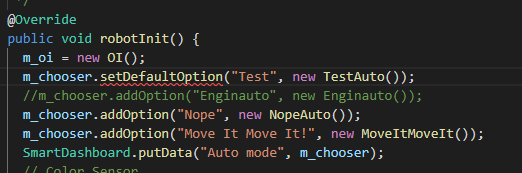

In this photo, my TestAuto file is an updated wpilibj2 command that I just made, and the rest are outdated commands. How do I add this new kind of command to my SmartDashboard?Capture2

I commented out all but the test auto option, it’s still mad at me. Any ideas?
What is the declared type parameter for the chooser?
string, command
Make sure Command is the one from the WPILibJ2 package.

What did you change to make this work? Ours looks the same.
I just made sure all the objects that sendable chooser was taking were wpilibj2 commands
The real irony here is that SendableChooser does not know or care what the actual types of its arguments are (hooray type erasure) and if you could make the compiler shut up about it you could totally mix-and-match types in the chooser without issue (not that that would be a good idea architecturally…).
